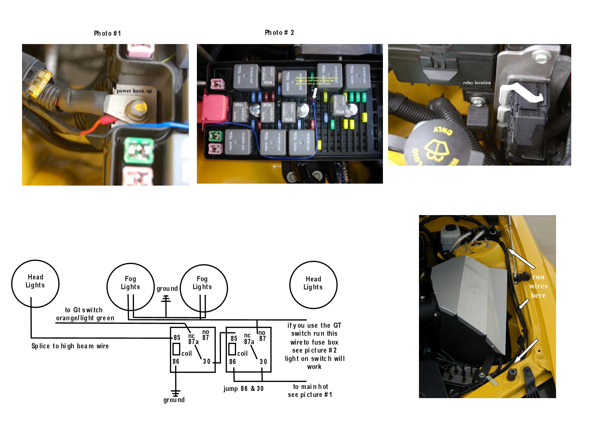

In what way did you wire those fogs in? The stock light switch pulls out to turn on fogs if the car comes with them, but other wise it lacks that ability in general. Did you replace the stock light switch, or add your own switch in a different location?
I replaced the stock headlight switch with one from a GT. I spliced into the wiring harness as shown in this you tube video and also used the info in this picture from the net. If you need anymore information just ask.
How to install Fog lamps on 05-09 mustang 4.0L V6 - YouTube
Thanks, I ask because in the very near future I'm going to install fogs in my 05 V6 that has no fogs.
