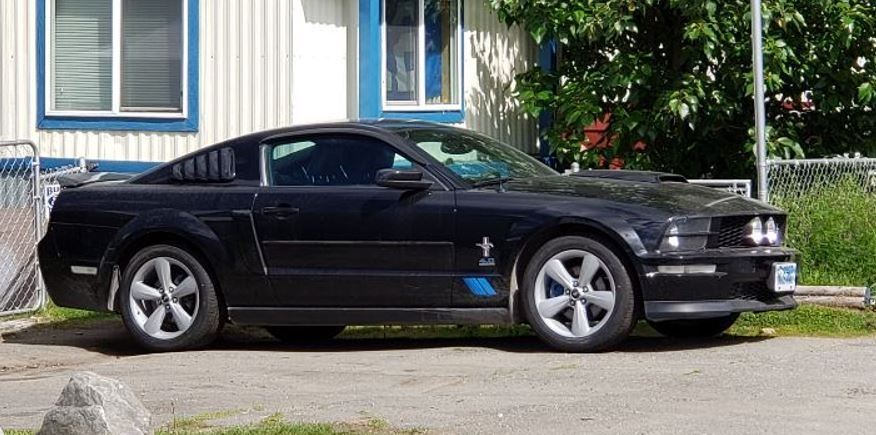

I installed the Steeda ultra lite springs. Front dropped 1.25" and the rear 1.5"(according to the site). I kept reading on websites like steeda, watched YT videos, and have asked around and was told that I needed the items I listed which is why I bought them. I do have control arm relocation brackets as well.
So I could have gotten away with my stock upper control arm and not have to fool around with getting the correct pinion angle? Then I wouldn't be in this mess. I'm going to try putting back my stock UCA (or a non adjustable since mine is old and rusty) one day and see what happens.
