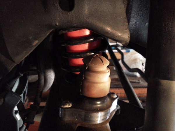

thanks for the info- just put mine in, will test drive in a few...on the mustang, worried about the air line up top, in looking it over, seemed better lines down, thru the axle mount, so they cant rub...flexing the line isnt ideal, but easily replaced if need be- followed the panhard rod, tied/looped, lines shouldnt flex much at all, but if they do will be along a decent radius/no rub...

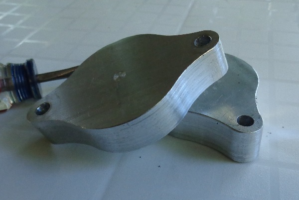

my new wheels/tires were a bit tight- adjustable panhard *might* help, the drivers side just barely rubbed the wheelwell when bottomed out on some rough rr tracks- rub was only 3/8 down the tire corner, so was going to make up some 1/2" bump stop shims... rather than have to remake them, made them 3/4", if it rides the stops to often I can mill them down a bit.
something odd on the S197- the bumpstop does NOT hit the center of its perch on the frame... I pulled the springs, jacked the axle to the stops, measured, milled up a set of aluminum spacers and put them in/jacked/remeasured... with or without spacers, the bumpstops in these cars hit on the rear angled part, pushing the stop forward a bit- you can see the clean marks on the perches where it contacts occasionally...looks like a design oops to me
update: 3 sandbags in the trunk and a full tank on some rough roads, some intentional bottoming, rides same as before? really thought hitting the snubbers 3/4 early would feel rough, but no difference that I could tell
after bouncing around loaded (just 1-2 psi) pumped it up while measuring, only took a bit over 15 psi to return to old height (only had about 5/8" drop loaded) and ride was only a tiny bit firmer if any... so extra kids/extra luggage/etc sholdnt mess up the headlight adjustment, and with the modified stops, no worries about the bigger tires touching.
