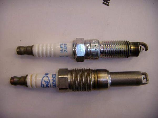

I've read that they changed the head design and plugs to prevent the spark plug problems.
Some places were saying late 07 and others were saying Oct 07 which would be after some of the 08s were produced.
The new plug uses a fully threaded surface. HJFS 24FP appears to be the new plug part number.
If you're an 08 owner and looked at your plug, what does it look like? When was your car built?
This was posted on modularfords and is supposed to be the different plugs.

If the picture in the OP is accurate, then it looks like there has been not only a change in the plug design, but also a change in the plug hole in the heads. The threads, besides running further down towards the tip. look smaller in diameter and start lower on the plug.

It looks like they went back to a traditional spark plug hole design. Hopefully they have more than 3 threads holding the new revised spark plugs.

OK. Finally had time to pull a plug off my 08. Unfortunately, It's the same Motorcraft 2 piece design part # PZT1F.
So at least for me, no "'New " plug design or head change.
On the plus side the plug came out very easily, no lube and undone with fingers after cracking it loose( no strange noises either)
