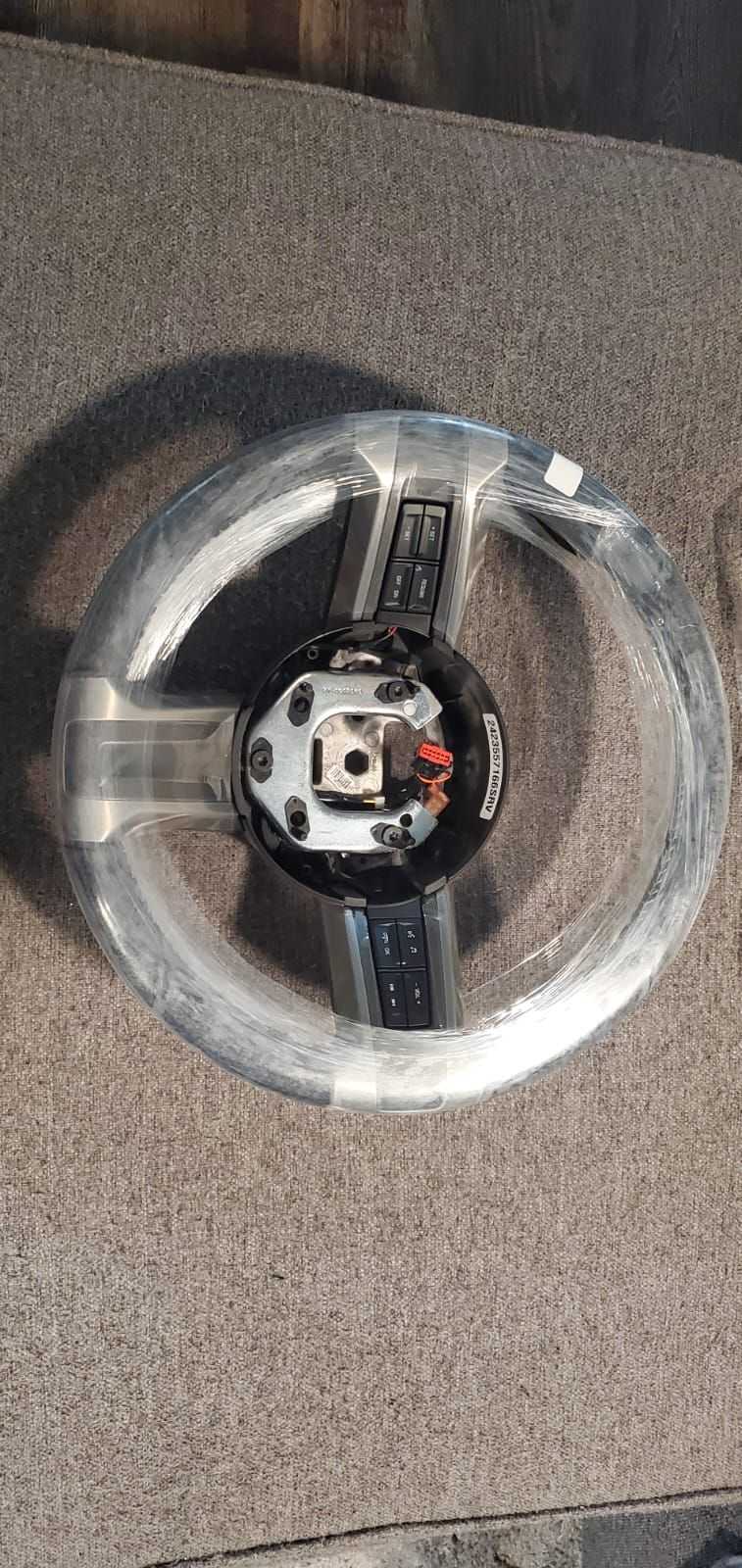

Also, im trying to upgrade my steering wheel to the newer version with radio controls from the 2013 models.
Do I need any specific adapter or something to get the buttons to work? (My radio head unit is an Atoto S8).

Do NOT follow that guide for the steering wheel. You do NOT need a PAC module in order to get the steering wheel to work.
As I mentioned before, use Akdoggie's guide here in this forum. Here it is.
https://themustangsource.com/forums/...o-mods-528705/
There is a Pdf at the end of his post. Also make sure you have the correct audio buttons for the wheel. There are 2 versions. If you go through the thread you'll find out which ones are needed. I don't remember off the top of my head.
If you have any questions lmk. Good luck.

@VGMStudios
THank you! the PDF was really helpful, I'm still totally lost but should get better once I actually start the project.
RIght now, I'm hunting down the 2x WPT1242 connectors. These are the only things I'd need right? Unfortunately they're out of stock almost everywhere except Tascaparts (bad reviews). Even Carid does not have them in stock. I'm trying to get them delivered to my colleague before Friday (he is coming over ot Germany this weekend).
Am I missing anything else?

@VGMStudios these are the pics of the steering, it looks exactly the same, so hopefully there wont be issues?

Okay great. Thanks for the picture. It looks like you have the correct buttons so that's great!
I was going to say that you can always put things in your cart on rockauto and go to the checkout page to see shipping options and when everything will arrive.

@akdoggie @VGMStudios
First of all, happy thanks giving and thanks so much for the help!
Just got all the parts from the states and have been playing around with the wiring.
Good News:
1) Got the Steering installed and managed to get the Cruise Control to work.
(it only works once I'm in third gear)
Bad News:
1) The buttons are blue! It really, REALLY bothers the heck out of me since I'm trying to keep everything neon green inside . hopefully I can reset the colours?
2) Guys, maybe I'm really dumb, but I've read page 3 of the manual atleast 5 times but after each reading, I get even more confused.
Is there a video or something I could watch? Basically, I'm stuck getting the Radio Controls to work.
Just so I didnt miss anything, right now, the cruise control works, I had to cut the cable head from the old steering and wire it to the new steering. I've 2x WPT1242 for the radio controls.
(Not sure if this is relevant but my radio is an Atoto S8 Pro).

@Jivesh1
What are you confused about specifically? When I first did it I was very confused so I know what you are talking about. If you can tell me what is confusing you I'll be able to help more.
Btw I'm in Canada and my turkey day is in October.
As for the steering wheel button colours, you can change them but you'll need to solder new ones in. They are a light blue colour. I didn't like it either as my colour scheme is blue so I soldered in new LEDs.
