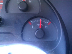

It's not crazy high, it reads between the 'm' and the 'a' on 'normal' I was just wondering about it. Thank you for the link, it really explained a lot
Old Feb 22, 2012 | 12:37 PM
irishn8's Avatar
Joined: January 15, 2012
Posts: 61
Something like that?
Np glad it helped.
