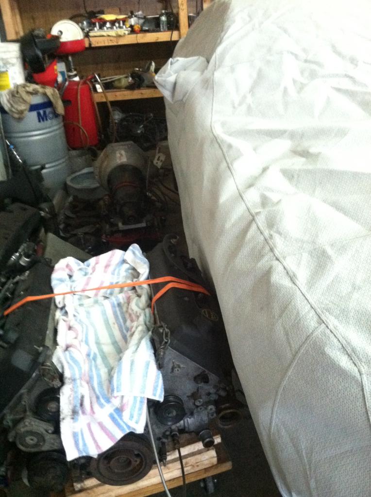

Old Jun 6, 2014 | 08:04 AM
  #93
slostang's Avatar
Joined: June 24, 2011
Posts: 755
From: Delaware
All this looked way better in the car!
