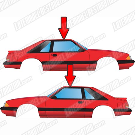

It's pretty simple to do. The only hard part is having to weld at least a 1/2" strip of metal inside the qtr. window hole. This is so the front bolts of the 87-93 windows have something to bolt to. There is another option. I did this on a customers car who wanted it fast. I took the mounting hardware that holds the 79-86 window in and modified them to make anchors for the 87-93 windows. Worked great with no issues. However, to do it 100% correct, it needs the metal strip added. You will also need the roof trim rail moulding(see pic). Another thing to think about is the difference between the 79/86 to 87/93 interior qtr. panels. These must be changed also when doing the window conversion. IF the 79-86 ones are not change for the newer ones, there will be a gap between them and the later model style qtr. window. I will try to get pics tomorrow. I might also have most of if not all the parts you need if you decide to pursue this.
