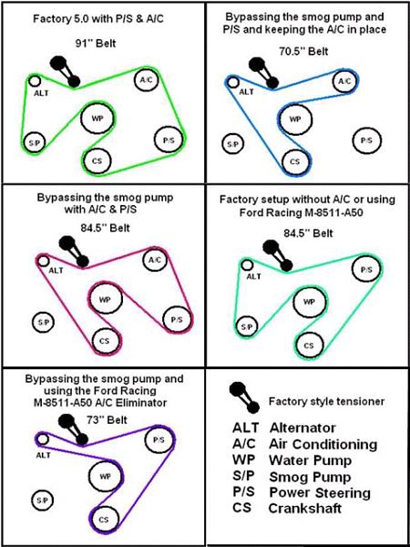

you can plug the head with a short 5/8 11 bolt. and this should give you an idea on belt size

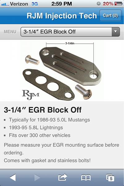

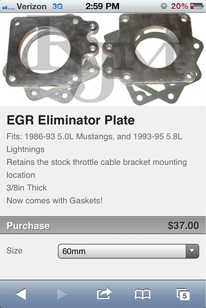

Will I need both of these? The plate says it retains stock throttle cable position is something I noticed...
Attached Thumbnails Smog pump delete-image-2236917097.jpg   Smog pump delete-image-3938005339.jpg

You only need the block off plate to keep the stock egr spacer and you are done. If you remove the stock egr spacer then you only need the spacer. keep in mind people have had issues with the spacer clearing the coolant tube and cruise control issues. you will also need to cap off the coolant hoses going to the stock egr spacer once you remove it. you only need one or other not both.
If you just want the simple route get the block off plate, it covers the opening left after you take off the egr valve. just bolt on the block off plate and your done you don't have to mess with anything else.
I have found mixed results with the simulator so I also wanted to point that out also. some guys haven't had great results which can happen since you are only fooling the computer. the true way is turning the function off like I stated via a tune but it may be worth the try.
