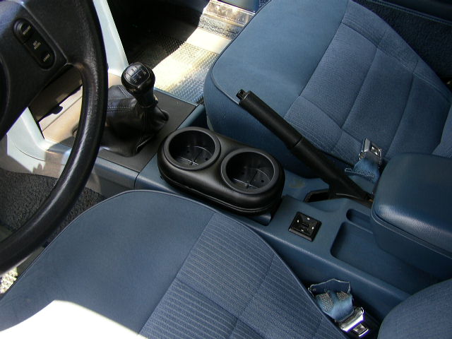

I was messing around there the other day, and I had to take off the black shifter panel, then there were a couple screws under there, and the console top popped up. You can't get it out/up all the way, cause it's attached to the console/armrest. It was enough room to mess with the ash tray cover though. I think all you should have to do it replace the spring. Mines broken too, but I put a useless cup holder there instead. I think they only cost $6-7. The previous owner put velcro on the cover to keep it closed, and I haven't been able to get all of the residue off yet.

Pretty much every mustang place has them. They just drop in, but I can't use it much because if I put anything in it, like a water bottle, it gets in the way of shifting.
http://www.latemodelrestoration.com/...ng-Cup-Holders
Attached Thumbnails how do i fix a broken ash tray cover?-summer-b-days-06-189.jpg

I just extend my lighter element out so it 'catches' the door closed... kinda works. That cupholer looks like a cool idea, being i use the space between the parking brake and seat to hold my cups, but I guess I cant use the socket if its in there too Notch- try using 'Goo Gone' to get rid of that adhesive mess.
