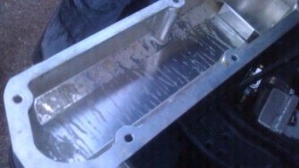

My topend is pretty much brand new.this was my 3rd drive and all of them short.I got on it pretty hard.when I slowed down my engine started making lots of noises and clanking.so I shut it off and pulled the valve cover.inside the valve cover was the infamous white creamy substance(see pic).so I assume head gasket.

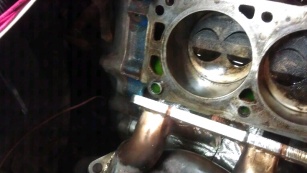

Well today I pull everything off and the head gasket looks great(see pic).I am very confused.I did use stock gaskets with a 4.030 bore.but they didn't overlap into the bore.I visually checked for cracks on the deck.and now I don't know what to do.please help.

Couple questions. Are the heads new? If not were they checked for cracks and warping? Do not reuse those head gaskets. Did you torque them correctly? Clean all the water out of the thread holes before you try and install the head bolts. Also go to autozone and buy a can of copper coat. Spray the head gaskets generously on both sides with a coating of copper coat. The head gaskets also may have a top and bottom or may be side specific.

Yes the heads are brand new trickflow 170.I used arp head studs with the supplied thread stuff that came with them.yes I did use a torque wrench in the proper sequence.I took my time prepping the deck.I ran a stone across it to make sure it was smooth and burr free.I even used a straight edge and a .004 feeler gauge to insure that the deck wasn't warped.

If the head gasket was the issue shouldn't I see some kind of signs were the failure/leak was?I am just worried that I may have cracked the block of something of that sort.

Was the head gasket supplied with the heads? Trick flow may require a special gasket. I always use copper coat on every head gasket I do just to be safe. Dunno man.

It could have come from the intake also. I would have done some testing to rule out the head gasket before i tore it down. That said doubt you would see a blow out area on the gasket when it was more due to a sealing issue. I take it you used the 10112 gasket set? I never used any copper coat on my gaskets but it may not hurt. IMHO I would clean the block surface more. Really if the head/block surface is straight and prepped. The gasket is laid on correctly and facing the right way. The bottom bolts that go through the coolant passages get thread sealer on them and it is torqued right you should be good.
another area that causes issues is the intake, more the coolant passages going to the head. These can leak w/o you seeing it and get into the oil. I use 2 types of sealent Permatex right stuff and regular "black" sealent. I ditch the "cork" or "rubber" end gaskets for the intake but most important I put a very thin coat of regular black sealant ( not "right stuff" it is too thick) around the coolant ports to aid in sealing on teh both the intake and head, use your finger to smear a thin film around the ports. I then lay a 1/4" bead of right stuff starting about a 1/4" or so on one head go across the block and stop about the distance on the other head, doing the same on the other end. This seals the intake ends much better.
I also torque the intake using the correct pattern but then go over it again. you will find the first few bolts are already loose. Sounds like you had a sealing issue either intake or head. recheck the surfaces, if using a torque wrench with extension remeber they change the torque value. make sure to use good thread sealer on the lower bolts.
