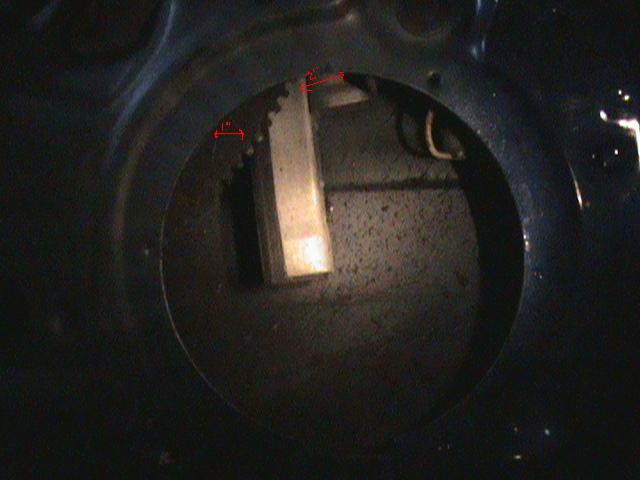

Ok, I took everything apart today, but there weren't any speaker wires. Another thing I noticed was how shallow the hole is. There's a couple of things that I think might get in the way of a speaker. The what I think is the window track, and a gear. With about 1" in front of the gear, and 2" in front of the track. Is there anyway to fit a speaker in there?

I managed to fit my cheap Pioneers in there
You won't find any wires dangling. IIRC, Ford used plug connectors for its speakers (at least in my 87). There should be a 2 wire plug attached to the inside of the door. If memory is correct it should be on the edge of an opening. Not the speaker opening, but the one above it, rearward of the window crank, IIRC.The wire plug should be there. I can't see that Ford would not have put it there.
My 87 didn't come with power locks. The power plug is there for them though in the kick panel area.

Maybe I'll have to look again. There were a bunch of wires, but they all seemed to be connected to something. It was really hard to do though in a dark garage with minimal space. Maybe I'll wait till spring to look again, if I can learn the patience. Otherwise I'll do it again over the weekend. I'd wait until spring to install speakers anyways.

yeah I think Coupe may be right...i remember seeing what he describes on the '87 I used to own. I had replaced the doors before repainting the entire car. I think there should be speaker wires there...idk if there is any difference between a GT and an LX when it comes to that, but obviously you'll find out when you tear into it...

Ok, I took my door panels off again today and they were sort of hidden under/behind the wires for the windows and locks. I was also able to fit my speakers in there perfectly too. Now all I have to do is run the wires to my trunk for the amp. Should be fun. Thanks for all the help!

I've used serveral different speakers in mine over the years. Rockford Fosgate Punch 5.25 speakers, Rockford Fosgate Audiophile 6.5" (had to build a fiberglass extension to bring it out 3/4 inch to clear the window gear, MB Quart 5.25 and currently have Cerwin Vega 5.25" in there which required a 1/4 inch spacer to clear the window mechanism but still fit behind the door panel.
