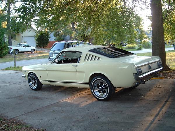

I have Goodyear Viva 2's white walls on my 66. 205/70 15's in the rear and 195/75 14's in the front.
