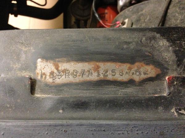

It's a 65 and on top of the left fender I have these numbers. Just wasn't sure if these made up the correct vin because it seems to have been double stamped if you take a look at the pic. Looks as if someone obtained a different vin from another mustang and welded it onto this fender

Looks like a double hit from the factory. Numbers and dies match up. Looks legit number to me. The question is whether its an original fender for the car. Does it match the door tag?

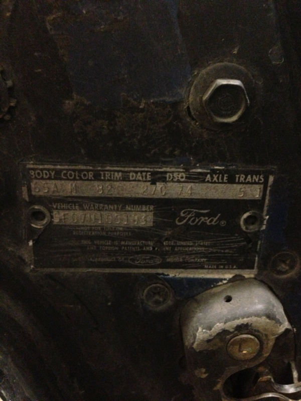

Here's the door tag

Old Dec 13, 2012 | 12:47 PM
FMSixtySeven's Avatar
Joined: March 21, 2012
Posts: 134
From: Reading, PA
Warranty Number: 5F07U105193
Year: 5 1965 (1964 1/2)
Plant: F Dearborn, MI
Body Series: 07 2 Door Hardtop
Engine: U 170 1v I6
Unit: 105193 105193
Miscellaneous Vehicle Data
Body: 65A 2 Door Hardtop, Standard Interior Color: M Wimbledon White
Trim: 82 Blue Crinkle Vinyl, Standard Interior
Date: 27C March 27, 1964
D.S.O: 74 Seattle
Axle: 5 3.50:1, Conventional
Trans: 1 3-Speed Manual
http://www.mustangdecoder.com/cgi-bin/decoder.pl
Old Dec 13, 2012 | 12:59 PM
Posts: 134
From: Reading, PA
The fender plate does not match:
Warranty Number: 5R07A125878
Year: 5 1965
Plant: R San Jose, CA
Engine: A 289 4v V8
Unit: 125878 125878
Old Dec 13, 2012 | 01:10 PM
AFChief's Avatar
Joined: August 31, 2005
Posts: 473
So either the fender or the door is not original (or both aren't). Next step (unless you have the title) is to check the right side fender. Not sure where the stamp is, but it is hidden. Also can check the engine. My 302 has the original install VIN stamped in the block at the aft end of the intake. I'm told they did this to various engine parts.
