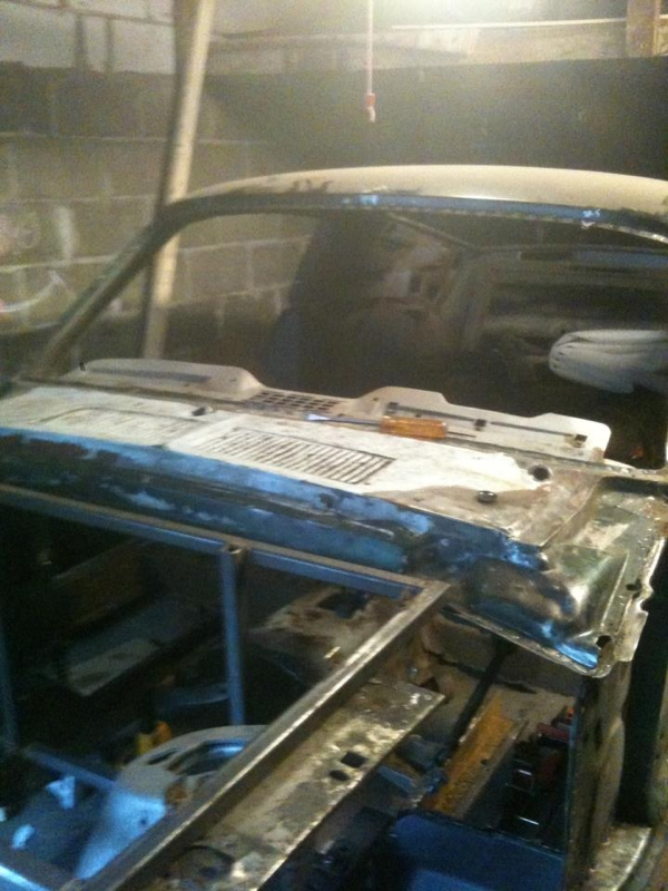

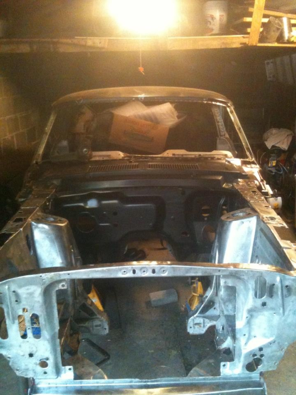

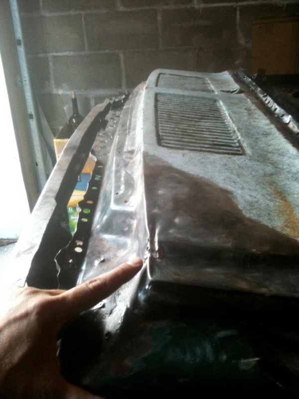

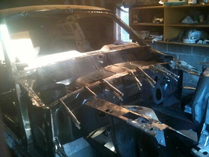

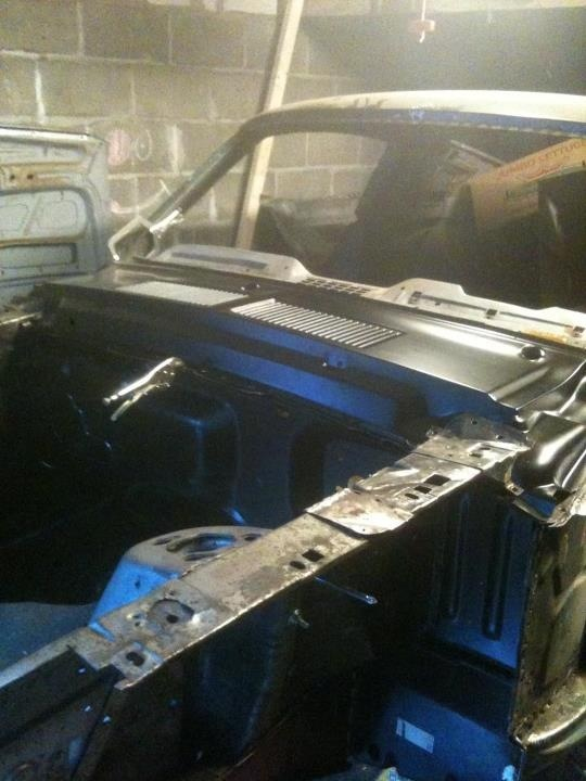

Fender aprons have to come off as well. Hard to see in the pics. You might want to take measurements of where your current cowl sits so you'll have a reference for when you install your new cowl. I marked center point and distance from cowl to roof line.
Attached Thumbnails Cowl repair for my 68  any pointers?-image-3827470004.jpg   Cowl repair for my 68  any pointers?-image-1186898064.jpg   Cowl repair for my 68  any pointers?-image-863710767.jpg   Cowl repair for my 68  any pointers?-image-911919153.jpg   Cowl repair for my 68  any pointers?-image-3417710919.jpg
