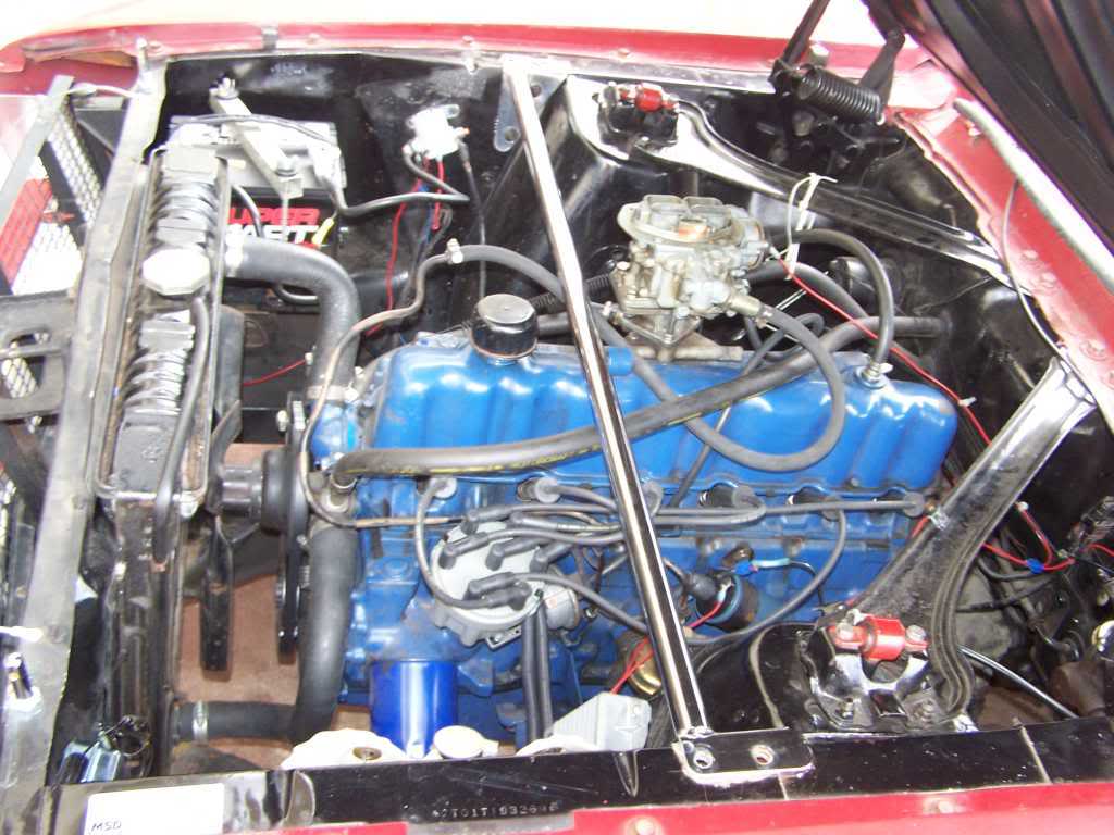

I bypassed the resistor wire once on my 67. 3 coils later I reconnected it and never had a problem since.

Originally Posted by matcox83
Only supposed to do it with electronic ignition. I imagine it would cause problems with points-type. Always (consider) following manufacturers instructions.
I know that.
I ran both the Pertronix and DSII setup, ran into the problem with the DSII setup.
Actually found an old picture of it.
