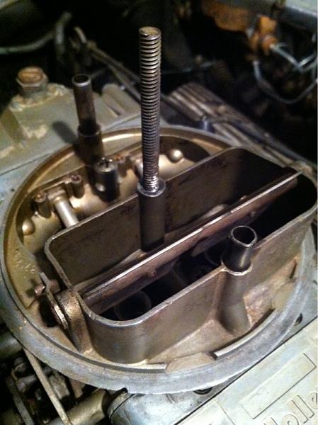

So the fuel is coming out of the front overflow pictured here.

wow !! a double pumper .. all it can be is a misadjusted or trashy or stuck float .. nothing else lets fuel in .. take the bowl back off and raise the float with your hand and see if it shuts at about a level position .. and actually blow with your mouth thru the fuel inlet and see if you can blow thru with the float up .. the big round screw with the hex screw below it is what adjusts the float level .. there will be a round screw on the left side of the carb that will be the fill level when set correctly .. fuel should trickle out of the hole when it is correctly set
