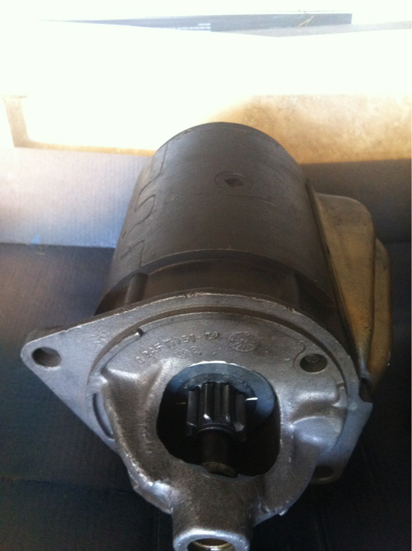

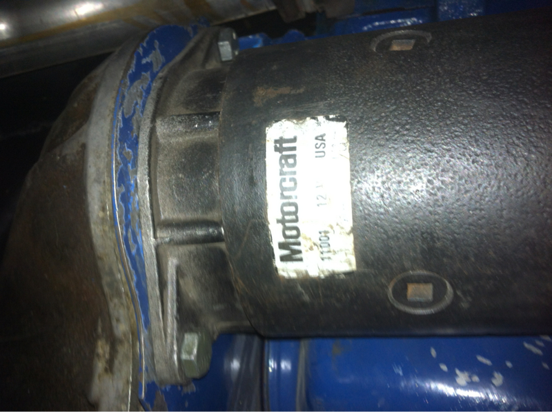

Thanks for the reply, I will look into all those things.
I think my biggest problem is the starter. Darn thing is probably not meant for this car!!! The guy at the shop who did the rebuild, changed the front end of it, said this is what the specs "call for".
I got it from the shop the first time and it sounded like it was grinding metal on metal with the flywheel! I took it back and had it recessed about a mm when I got it to turn over yesterday with a booster pack it turned over again but sounded like metal on metal again! I'm thinking this starter is incorrect!!!!! Starting to really rattle me!
I'm not an experienced car guy! Just trying to learn a little but but didn't want a car that needed a huge amount of work! Feel overwhelmed!
I have attached a couple pics of the starter and it in place w/o the shims!

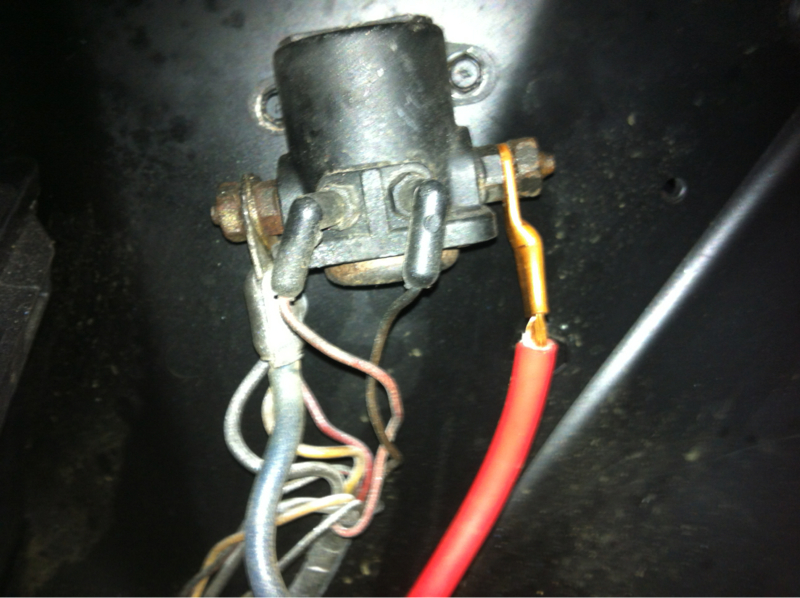

If you are running a multiple wire system, the wires may be hooked up incorrectly. There is a certain configuration where the starter will run, but will never hit the flywheel to start the engine. Starters do not just turn, the gear will move out to start the car and then recess back when you let go of the key. If you have the correct wiring, both actions will happen at the same time. If you don't, the starter will crank, but will not move in or out. Don't know if that helps, but I thought it would be worth saying.
