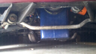

Forgive the bad picture...but this is what I'm looking at. Something tells me it won't settle enough. From a distance it looks like the car is climbing a hill. Perhaps I'll start at 1/2 coil.
Old Mar 20, 2011 | 08:57 PM
BA Mustang's Avatar
Joined: June 29, 2007
Posts: 4,133
From: Huntsville, AL
What is your tire size?
If it is P195/75R14 then you have a 25.5" diameter. I run 205/50R15 tire on my 67 and they have a diameter of 23.1". So 1/2 coil might actually end up just right for your.
