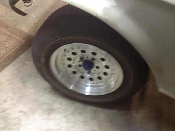

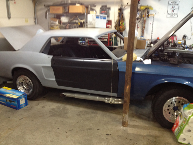

Use 15 by 7's or 15 by 8 inch wheels. I have the same setup on my 1967 Mustang. You may need to grind down the very tip of the end of the upper a-arm (the lip), especially if the suspension was replaced. No big deal, just don't want you to be grinding the inside of the rim down on a full tilt turn. Here is mine if you were interested in seeing my setup. Ask me about any other ideas you may have, I may be able to help you out.

You cannot use the original 14" rims because they will be too small with the brake calipers (I know this from experience) Fifteens almost always look good on an old Mustang, counting on the stance being right.
