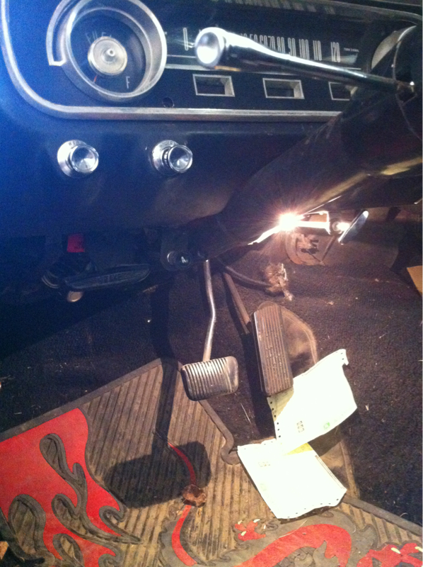

These are 2 angles of where the lightbulb is. I've tried all ***** again and still no luck. Only way out as of now was to disconnect the bulb
Attached Thumbnails 65 mustang light bulb question-image-2849358044.jpg   65 mustang light bulb question-image-600826327.jpg

Yup it's an interior light bulb..they both come on if u rotate all the way to the right I believe..it should turn of if u rotate the headlamp **** towards the left

There should also be one on the passenger side. When you turn the headlight switch **** all the way counter clockwise you should feel a detent. When you pass that detent the lights should both come on (if doors were shut). It does sound like you have either a faulty door switch (on the a-pillar at the front end of the door) or a short to power (the light fixture is always grounded). If you have a short to power it will always light but it is such a short (distance!) circuit that is unlikely. Have you tried unplugging the switch? Disconnect the battery then pry the switch out and unplug it. Does the light go out? You also have one on the pass door.
Old Oct 16, 2012 | 05:14 PM
matcox83's Avatar
Posts: 159
After you unplug the switch reconnect the battery! Then check light. Careful not to let the connector short to ground while disconnected
