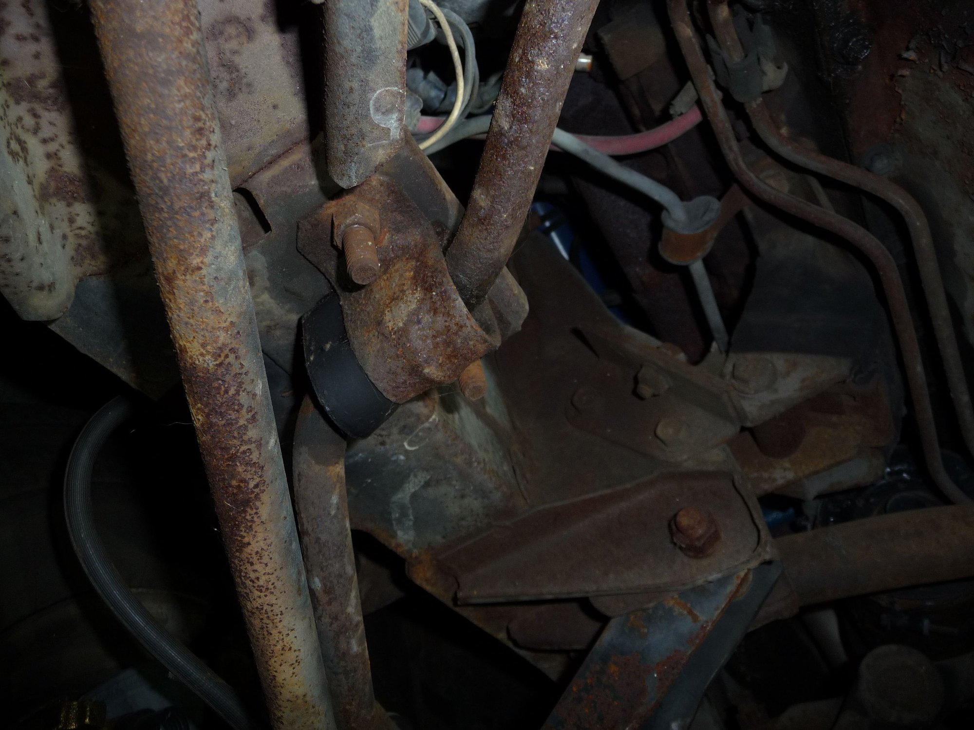

need a little help and info here.
i have a 66 mustang coupe. 289 v8 2bbl auto
my front sway bar and bushings are shot,
how easy is it to replace this myself without a lift? i just have the driveway, jack and jack stands.
i know the swaybar end links have been replaced but nothing else. also i noticed several different sizes when i went on CJ Pony parts....
should i get what is on the car or can i go up a bigger size with the existing end links without buying a whole complete kit?

That front sway bar setup is dead simple and really easy overall. Take the links off, take the two bushing clamps off, and it almost falls out of the car immediately. Be careful you don't hit your noggin with it. Just jack up the car on jack stands so you can comfortably work on it. Installation is the reverse of removal. Done!
Here's a video on the thing that'll help out immensely for ya methinks. It's an excellent video about the sway bars in general on that car.
Regarding the links... can't say the car's a big performer that needs more than stock links for any bar, stock or upgrade. You'd only go get bigger/stronger ones if you're snapping the stock ones off. The bushings are probably more important, switching from stock rubber to polyurethane would increase performance but also increase NVH in some ways. Trade offs, they're a thing.
Hope that helps! Good luck!

so another issue i have is that the bolts are all rusted and i cannot turn them with the wrench.
any suggestions to use to loosen them up? i sprayed WD40 on them and doesnt seem to budge.
any other ideas?
i think what im going to do immediate is to see if can loosen the brackets up enough to get the bushings back in place,
then in the spring i will just replace the whole thing since everything under the car is old, rusting, or just plain worn out....
i will do a complete suspension overhaul on the car in the spring and do it all at one time....

A product known as PB Blaster might penetrate better than WD-40. Heat helps too.

Ok, well, there's plenty of debate on this very topic, but the *best* stuff I've found?
Liquid Wrench Pro Penetrant. This exact stuff here:
https://www.liquidwrench.com/product...bricating-oil/
And how, you might ask, did I come to be enlightened about this stuff?
Short version: Clutch job. Gotta remove the H pipe. Nuts on the exhaust manifold flange would *NOT budge on the left side. Period. No way. And I tried other stuff. WD-40, PB Blaster... No go. I had my *big bad* breaking bar and not doing it. I was eager to NOT snap the stud on the manifold, of course. Air ratchet no go. Air impact gun no go, but my compressor's wore out. I went and got a *honking* electric impact gun, and trust me, it's *stupid* torque at max. No. Not even kidding. I go on the internet and discover this amazing person:
Skip to about 8:33 to see the torque values to get the loosening happen. Notice how Liquid Wrench Penetrant is the best out of all of those (including Kroil, the magic stuff everyone raves on), except for heat from a propane torch.
So I go to get it, but I wind up getting the 'upgrade' pro stuff...well, I kinda figured Pro meant 'more awesomer'. And sure enough, let that sit for 30 minutes, and *boom*, ripped those nuts right off pretty as you please with that honkin' impact... I put nickel antiseize on the studs before I put it back together to hopefully prevent that from happening in the future. We'll see. Pipes are still on and good, so it didn't affect the tightening aspect.
Oh, sure, one might say that the other stuff helped, but I don't think so, I don't think they even penetrated to work. *Multiple* applications of the other stuff and no go. A LOT of time wasted. This stuff? I was done in 30 minutes.
Yessirs/madams... Liquid Wrench Pro Penetrant. With the flashlight (it's actually kinda handy, that). I'm a believer, as you can see. I hope it works as well for you too, should you get it. I don't believe you'll be disappointed!

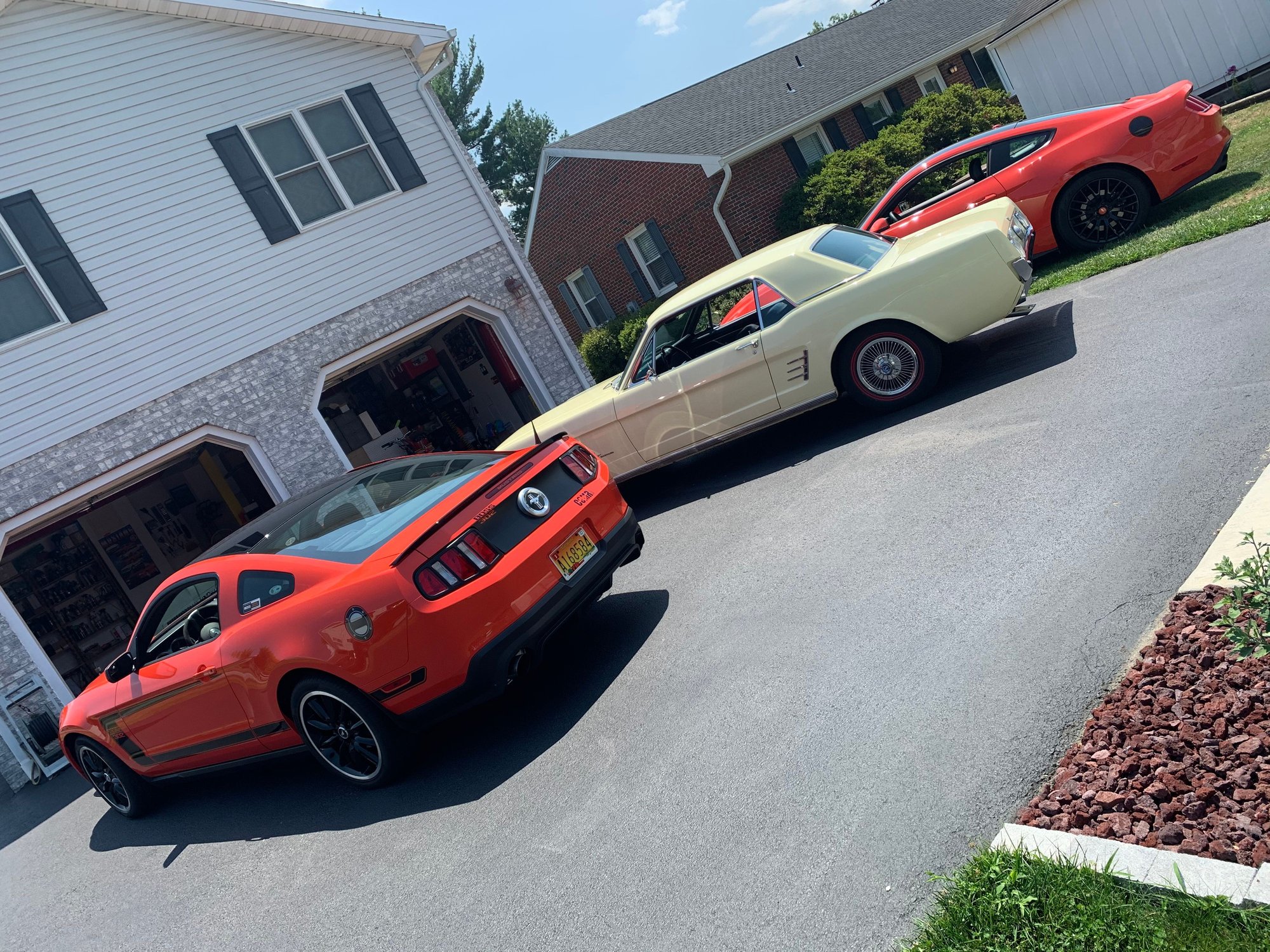

Old Nov 25, 2020 | 08:38 AM
SINBUSTER007's Avatar
Joined: June 16, 2007
Posts: 621
Likes: 12
From: Hagerstown, MD
here is all 3 together
Old Nov 25, 2020 | 09:28 PM
What a nice stable of ponies!
