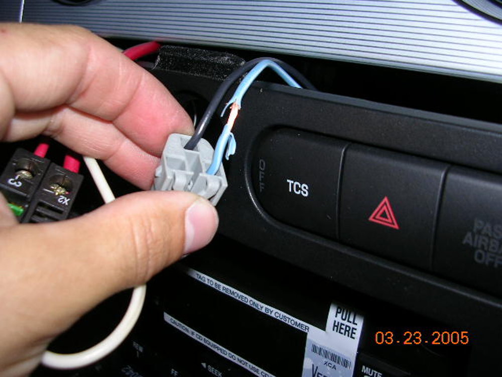

Before I forget to mention it, do not cut any factory wiring in this install, simply strip away the insulation as shown in the pics, and everything will also work as normal.

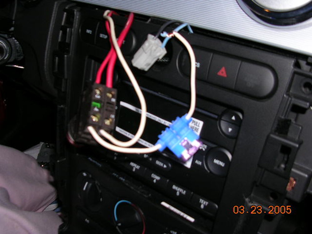

Wiring Up the Button

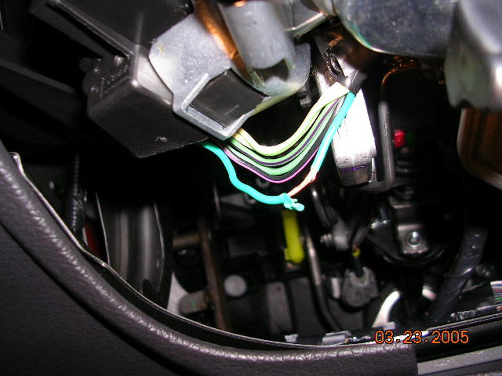

The first step is to run the wires from the factory starter wire to the area of your Mustang’s dash where you will mount the button. The OP explains how to locate the factory starter wire running to the key cylinder in the steering column.
Mustang Start Wire
Next, you have to pick a power source for the light in the engine start button and the OP chose the power wire from the factory cigarette light in his Mustang.
Mustang Button Power Wire

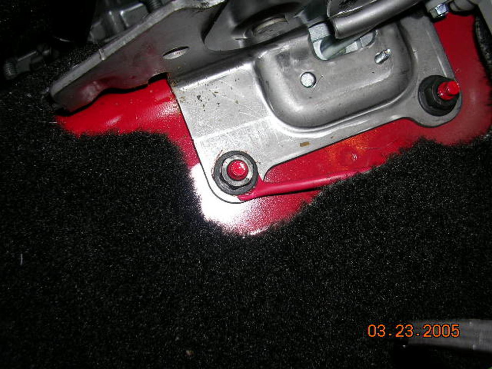

Finally, you need a good ground for the button, and the OP picked a bolt for the emergency brake, explaining where to run the wires.
Mustang Emergency Brake Ground

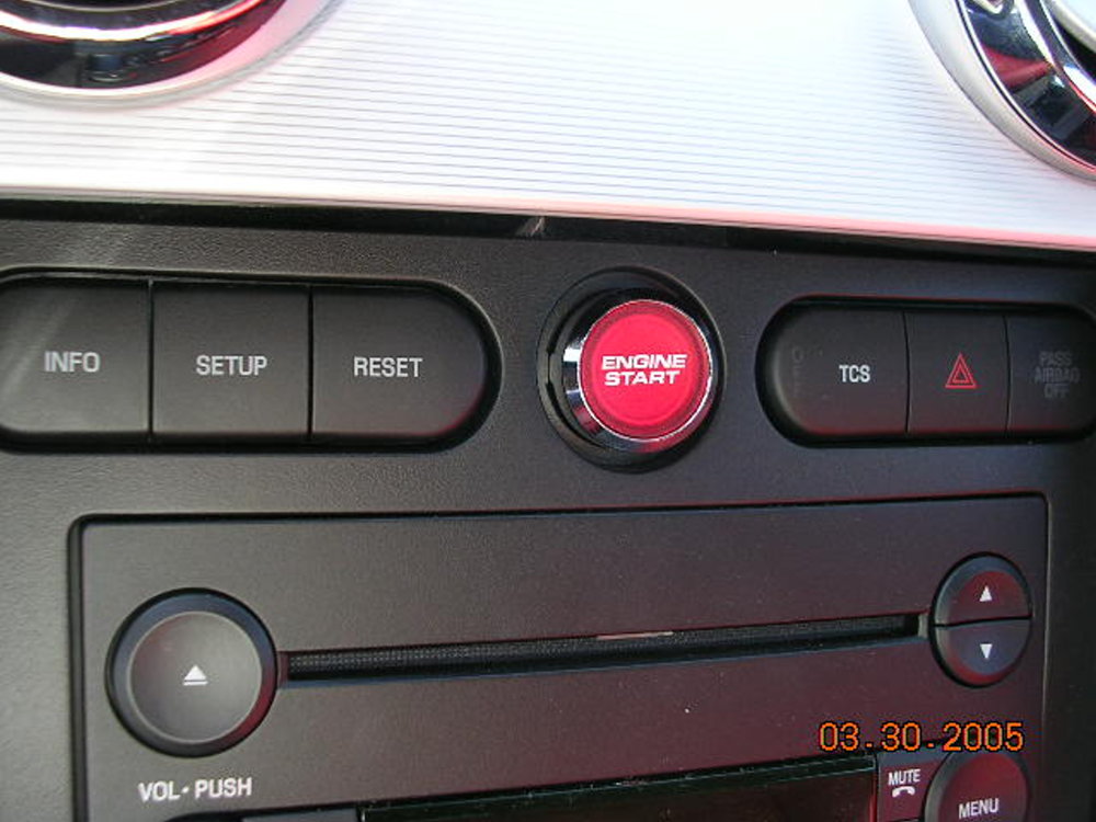

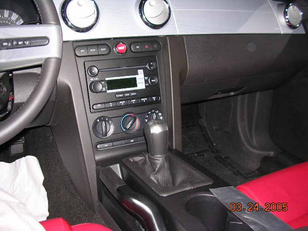

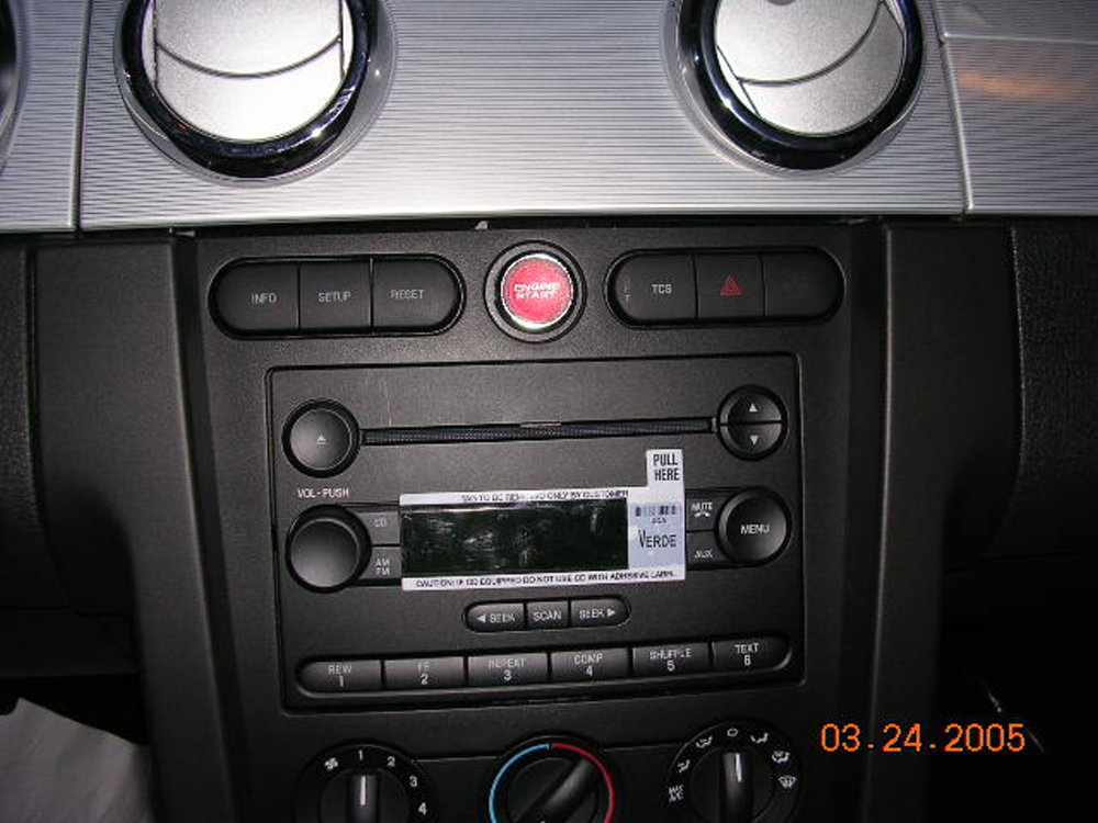

Once the wires are run, you just secure the engine start button into the console panel of your 2005-2009 Ford Mustang, button everything back up and you will have a functional push-to-start system in your S197.
Mustang Start Button Wide
