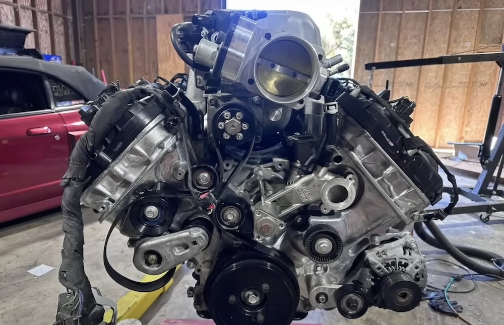

In this case, one will need to source a 2020-2022 GT500 takeoff supercharger as – unlike the standalone piece – it doesn’t come with pre-drilled holes for the fuel rails. Doing it this way also means that you’ll get all of the little pieces that are needed for the swap that can cost quite a bit to purchase separately, Next, you’ll have to build a fuel system, though the factory return-style setup is adequate with some updates, which are certainly needed if you’re going for the high-horsepower upgraded route.
How To Predator Supercharger Swap a Coyote-Powered Ford Mustang

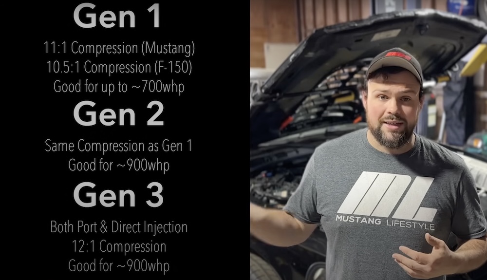

Depending on the generation of one’s Coyote and their desired power output, throttle bodies are also a consideration, though there are some ready-to-go options available via the aftermarket. The belt drive is also something that needs to be addressed – the easiest way is to go with an Odin unit from VMP, and there are various options in terms of pulley sizes that enable one to crank up the boost if so desired.
Of course, the cooling system will need to be addressed to keep under hood temps down, and there are more considerations that one must take into account for varying power levels and specifically, the Gen 3 Coyote.
All of that information is neatly outlined in this video – along with a link to a total parts list – which makes the Predator blower swap about as easy to reference as possible.
