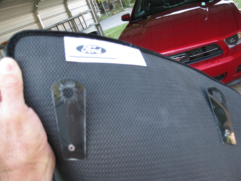

Here is the back of my Lloyds (driver side) mat. The locking tabs work and there is some velcro to hold the 'dead pedal' part of the mat in place.
Attached Thumbnails 2011 Lloyd Velourtex Mats vs MCA Premium Mats (with pics)-img_0373.jpg

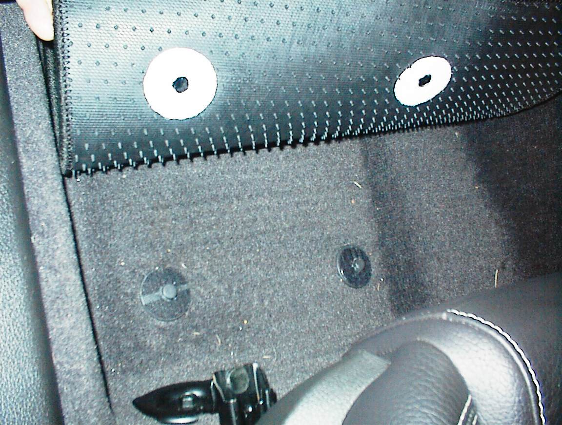

I got my Lloyds mats from Late Model Restoration ... they are the "Heavy Plush" type in Black with no logo (#010061).
The metal retention eyelets in the mats fit over the '11 retaining posts, but do not STAY there as others are experiencing with this style mat.
My solution was to add adhesive-backed VELCRO around the posts on the plastic plates in the carpet and the same on the bottom of the mats. However, the adhesive did not stick to the bottom of the mat for more than a week. So, I went and got some 2" wide "sew-on" velcro and cut 2) 2" dia. pieces with a 9/16" dia. cut out of the center and glued these to the bottom of the mat with "Shoe Goo" ... so far so good !!
Doug
Attached Thumbnails 2011 Lloyd Velourtex Mats vs MCA Premium Mats (with pics)-lloyd-mat-velcro-fix.jpg
