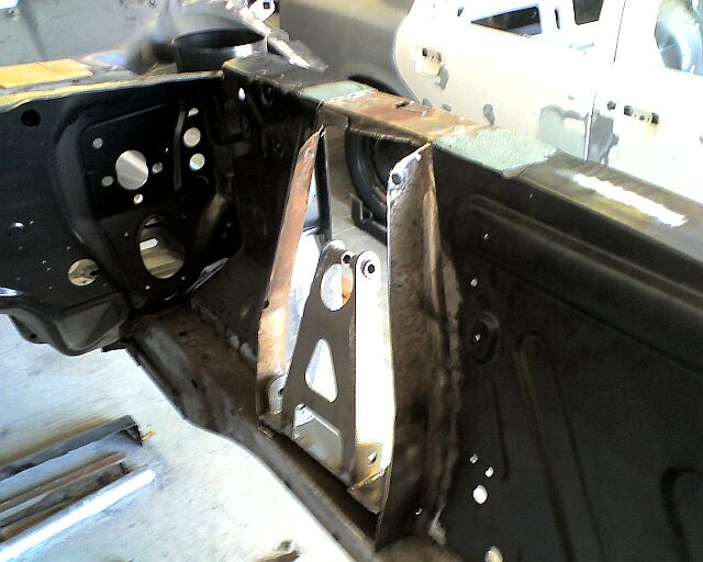

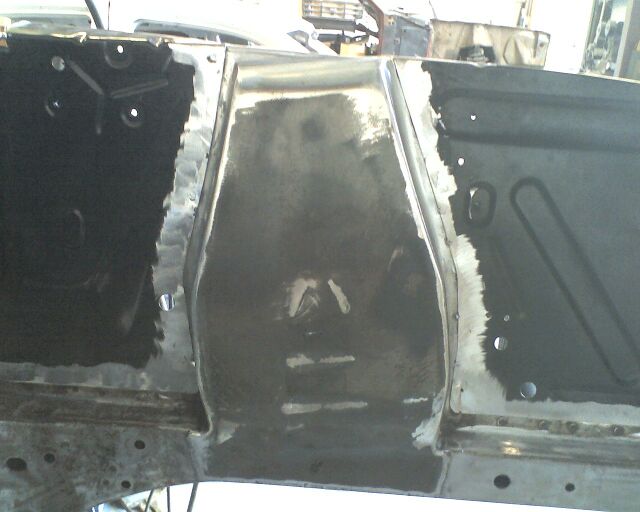

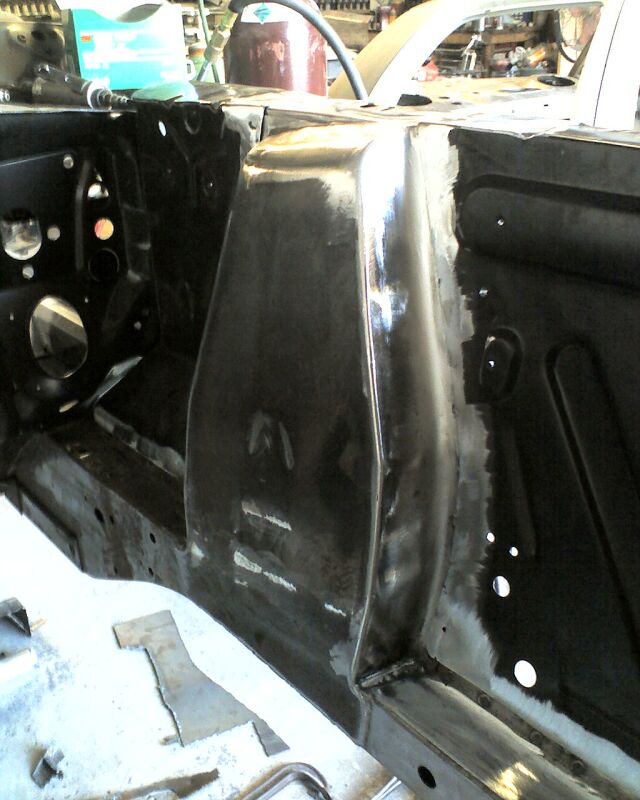

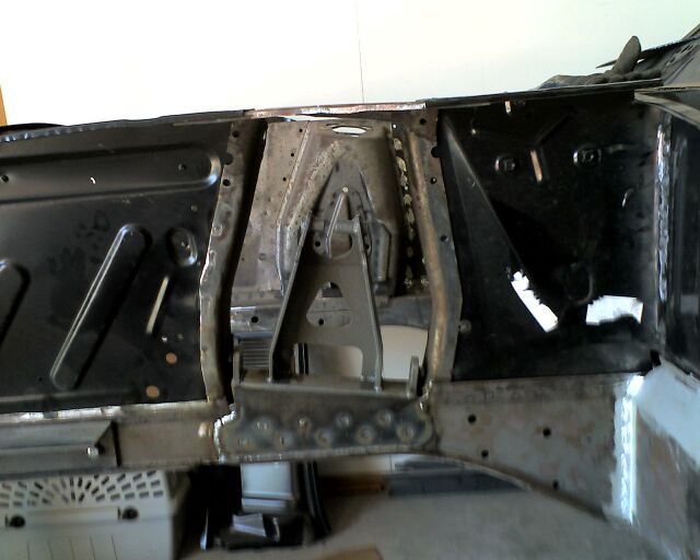

Here is an update on the start of our shock tower fabrication. With the mini towers welded in it was time to cut out the towers to gain clearance for our Terminator engine.
Attached Thumbnails 67' Shelby Project-09-29-08_1142.jpg   67' Shelby Project-lhtowercutout.jpg   67' Shelby Project-09-29-08_1740.jpg   67' Shelby Project-tower.jpg
Darn what a problem to have

Since you have cut out the old shock tower to make room for the new engine, will you be fabricating new motor mounts or is this something else you have orderred?
Old Nov 11, 2008 | 03:07 PM
  #127
svopaul's Avatar
Service Manager
Joined: June 29, 2004
Likes: 626
From: Odenville, AL
Part of the Griggs GR350 suspension includes motor mounts...the lower crossmember has provisions for the mounts and the mounts are included with the Griggs kit for either a pushrod windsor engine or a 4.6 modular.
