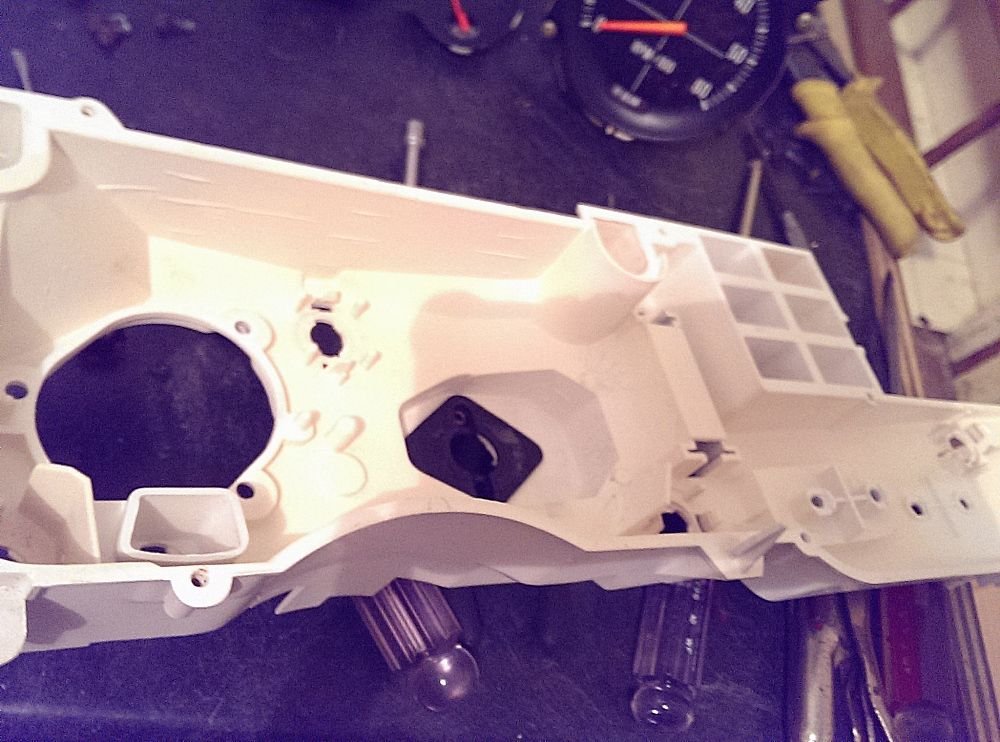

New printed circuit sheet, cleaned up the gauge pod, installed the Suntune II tach in the stock tach housing, so it's sort of almost looks stock.(especially since it's a "II" tach) used LED bulbs in ICY BLUE, I love the color. I tested a spare gauge clear cover, wet sanded it with 1500, then 3000 grit, and cleaned it, then I used headlight clear coat on it, and the results were surprising. It started out scratched and ugly, I was about to throw it out, glad I didn't!.

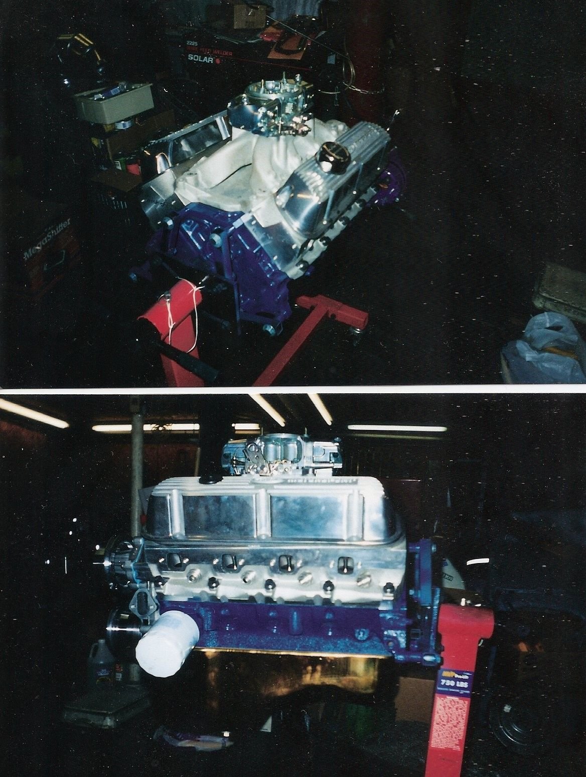

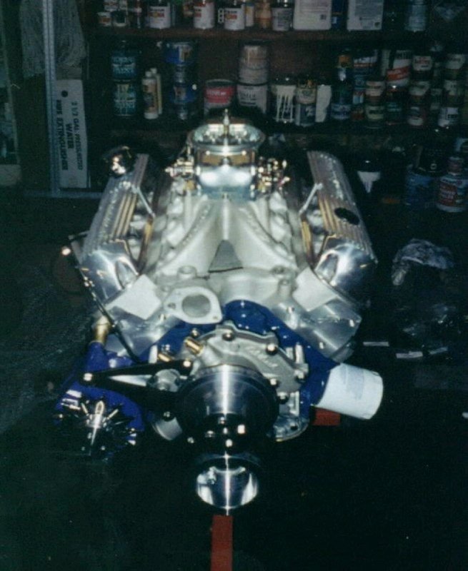

With the 530hp in a 2450 lb car, traction used to be an issue on BFG radials even with the 3.10 axle gearing. For years I never knew what the car could do at full throttle in 1st gear. lol I had to launch in 2nd gear at no more than half throttle to hook it. However I went with 255/40ZR17 Toyo Proxy R888s on '95 Cobra R wheels, and I was finally able to see what the car does launching it in 1st gear. It was a pleasant surprise.
I actually have a video from way back around 2000, the car still had 14" wheels on it with little tires lol That was right after I built the stroker for it, those tires and wheels got replaced soon after.
