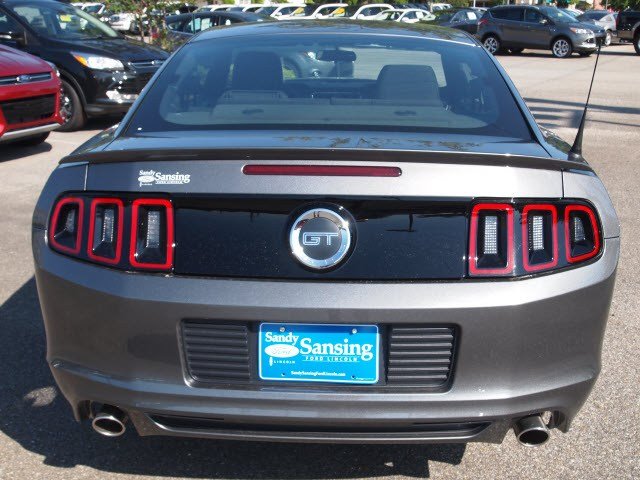

It it's just the little sticker like in the picture, use your fingernails to catch the edges and pull it off piece by piece, followed by some wax. That is the first thing I do with any new car. If they gave me an extra $5K off, I would have left it on but they are not paying me to advertise.

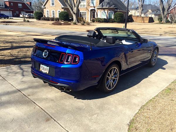

I added the GT500 lower rear diffuser. When you remove the bumper on a 2013-14, it is already marked on the back side by Ford where you need to cut to install the diffuser. After that, the GT500 axle backs are a direct bolt on.
