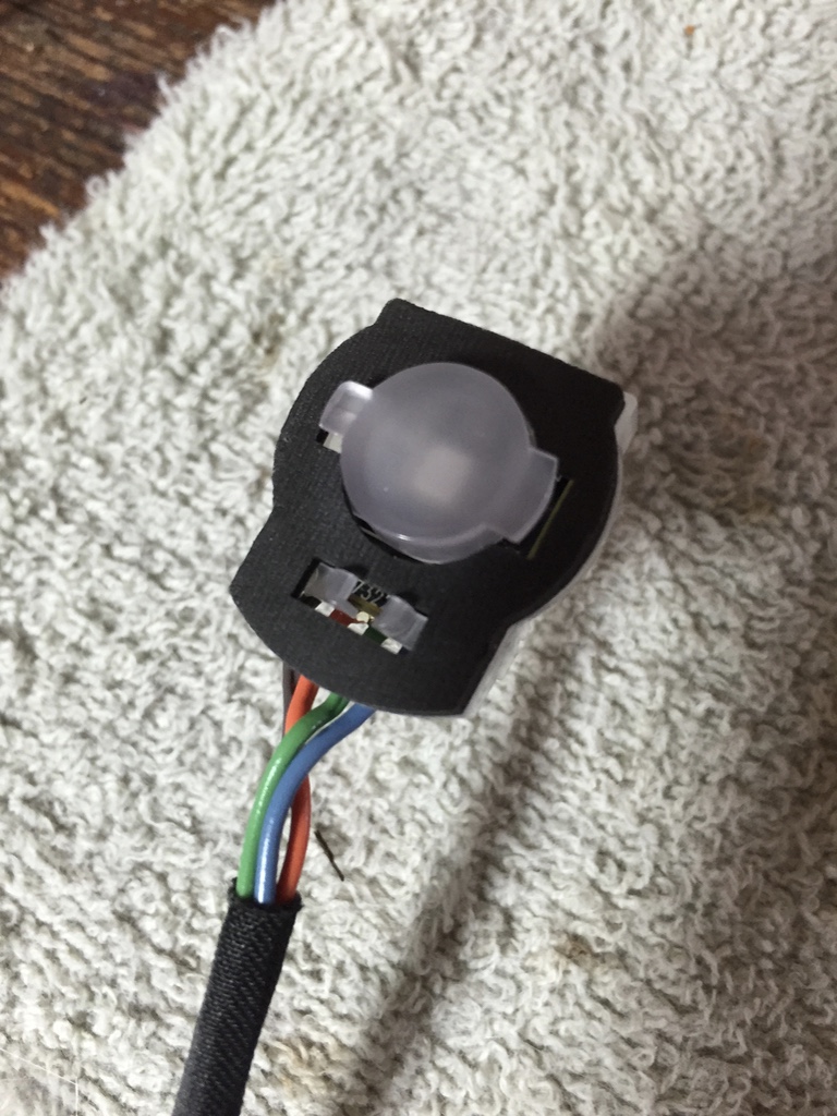

Hi guys,
I have the exact same model and issue. I bought the Roush version and there is no power to them although they plug right in. I removed the My Color light and attached harness from under the footwell on the drivers side. Real easy to do. Even easier on the passenger side. My plan is to solder into this cable on the bench, then reinstall and run the wires down to the plugs at the sills. Honestly this should be very easy. Im traveling now but hope to have it done at the end of Feb. I'll take pics.
Here is the harness prior to any splicing.
Mike
Attached Thumbnails Illuminated door sills-thumb_img_1869_1024.jpg   Illuminated door sills-thumb_img_1870_1024.jpg   Illuminated door sills-thumb_img_1871_1024.jpg
