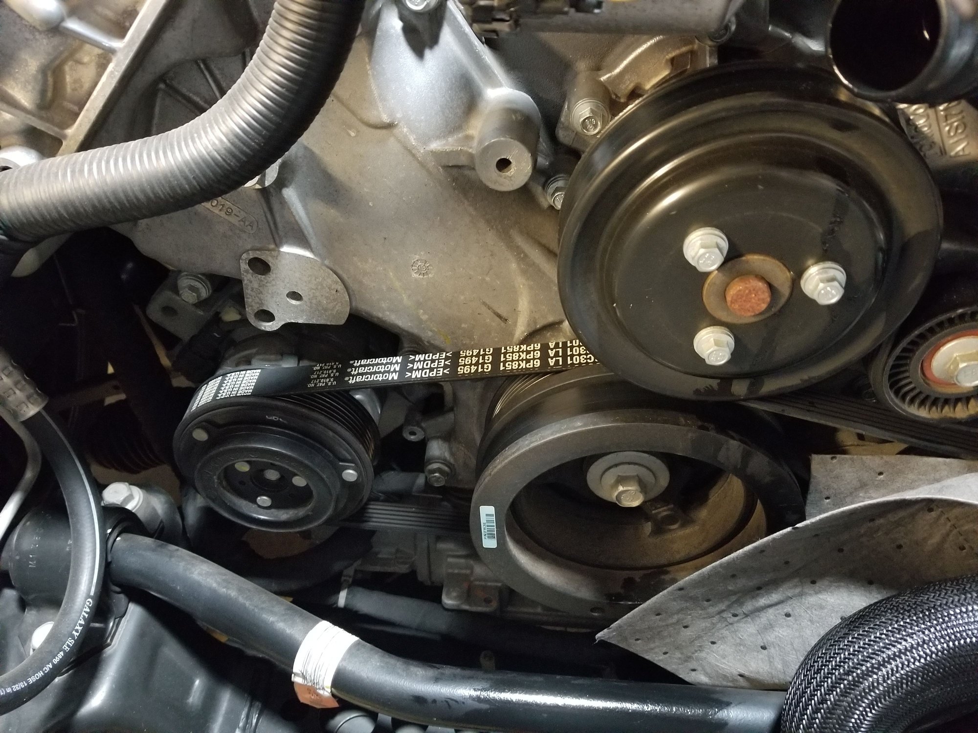

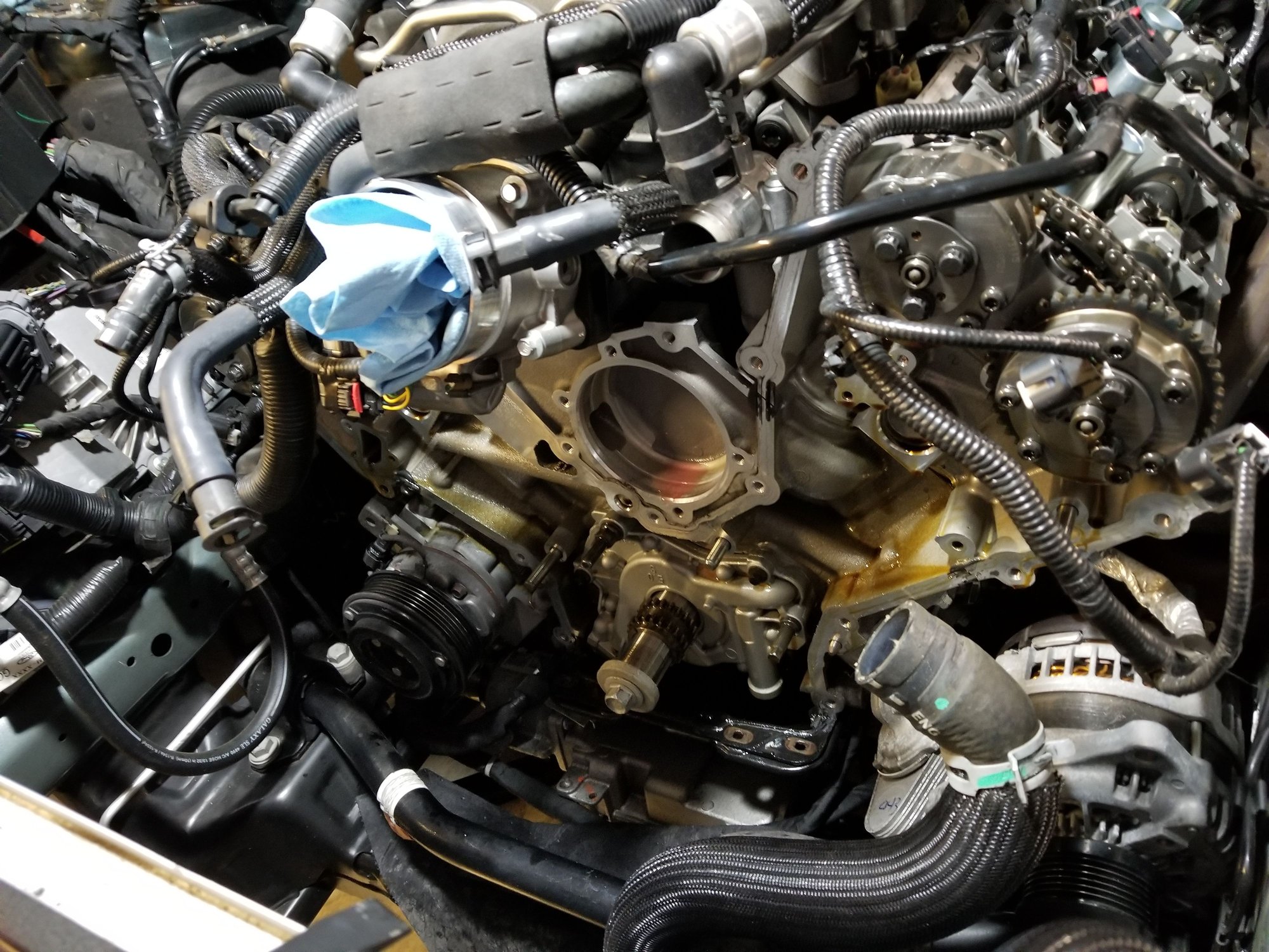

Just figured I'd share some pics from the SC build. It took 4 days because we also did OPGs and CS sprocket. If anyone has any questions about installing a procharger on a 15-17 s550 or OPGs, everything is fresh in my mind I also have the factory service manual so if anyone needs help I can do my best to look anything up for anyone as well.
​​​​​​Overall it wasn't that difficult of an install. The worst part was pulling off the crank pulley.
My advice for anyone. Invest in the right tools It makes life much easier and less risk to break something.
The things no one told me even when doing all my research with YouTube and write-ups:
1-when pulling off the drivers side valve cover, everyone warns to not break the dipstick tube, but no one told me that you can remove it before attempting to take the cover off. As careful as I was, it broke. You can remove it BEFORE hand very easily. Learned that the hard way.
2-Procharger says that you will have to bend the heater outlet tube that connects to the water pump slightly... That is downplayed. It is very difficult to bend. And if you bend it too much it will kink.
3-If you're doing your OPGs be prepared to cut off the belt that goes from the crank pulley to the AC compressor. The Ford factory service manual tells you to cut it off. There is no tensioner. Reinstalling the new one requires a zip tie and some muscle. Yes, a zip tie. Lol
Everything else wasn't bad just time consuming. Here are a few pics.
