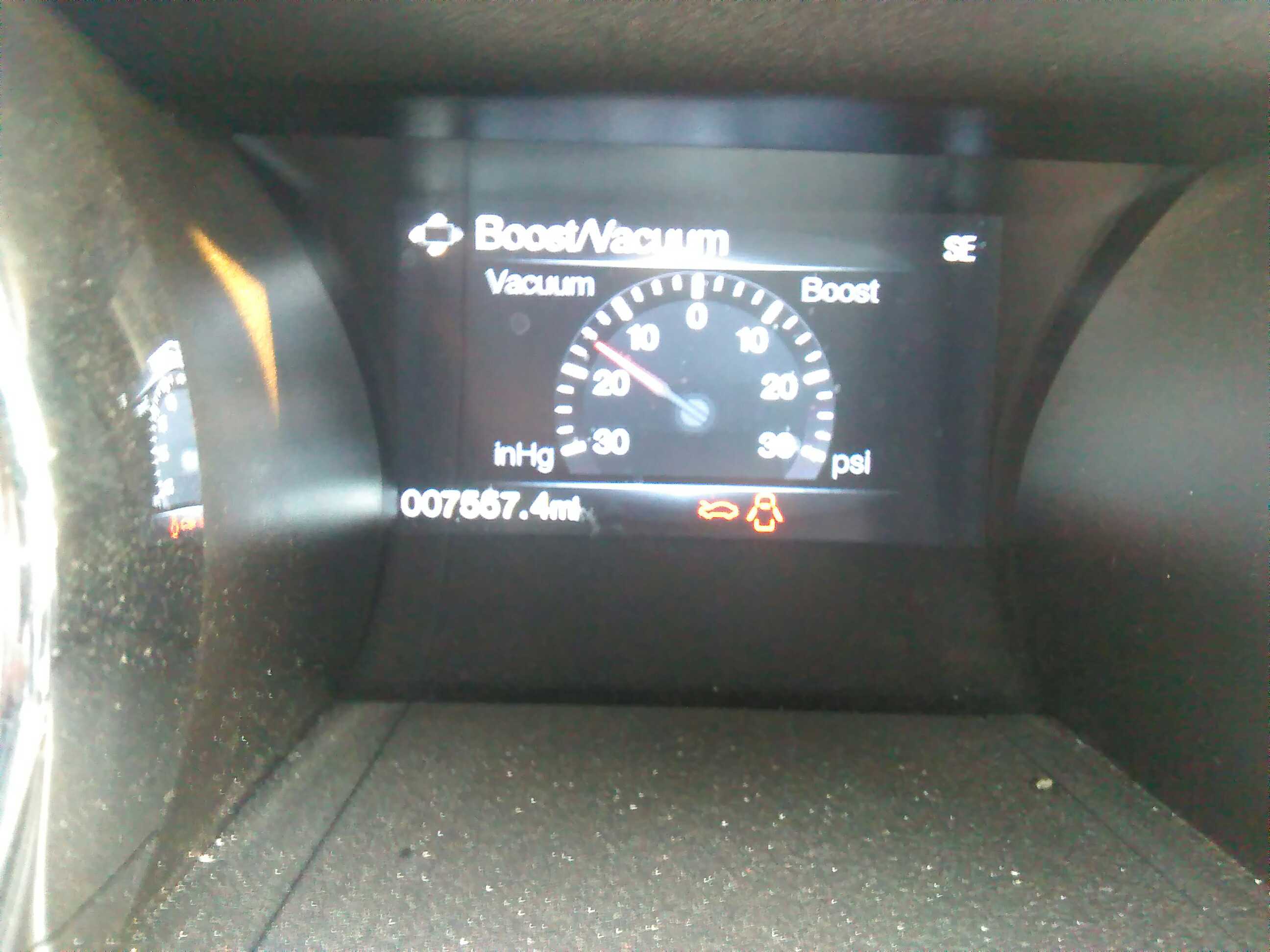

First off your car already has a boost gauge in you Gauge Mode option! It goes to 30psi!

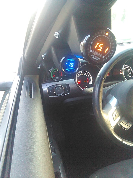

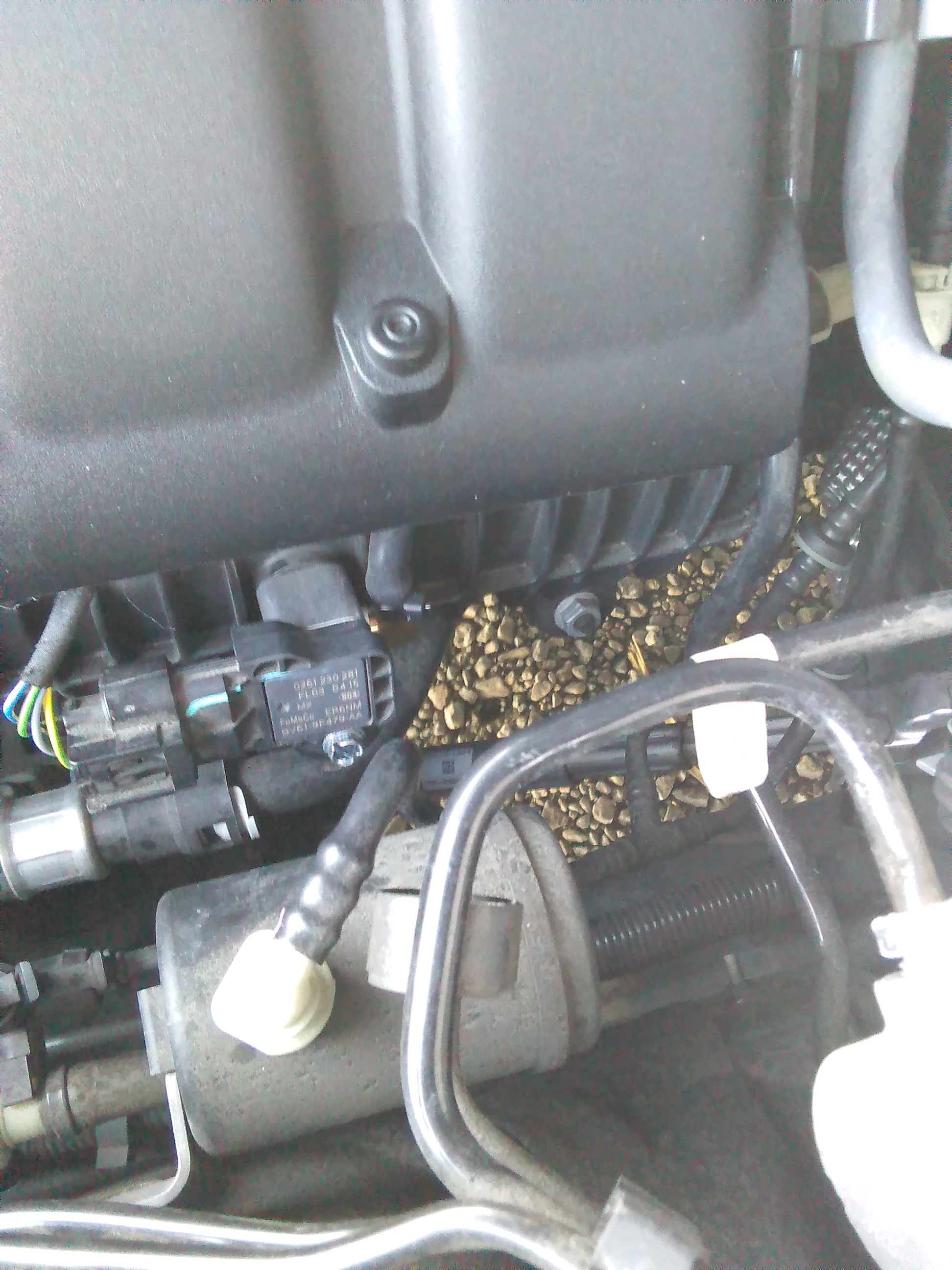

If you want to mount an external gauge like mine on the A pillar, you will have to buy a gauge pod from eBay, and also a vacuum CNC machined block with an extra port behind the throttle body! Its for a Focus ST but also works on the Ecoboost! I'll post a picture of my gauges and also the CNC machined fitting, which you can purchase from ATPTurbo.com for $39.95!
Old Mar 30, 2018 | 11:25 AM
msp.ecoboost's Avatar
Joined: November 14, 2016
Posts: 207
Here you go!
Attached Thumbnails performance boost gage-tmp_5754-img_20171208_161545245534176.jpg

CNC machined aluminum vacuum block!!
Here you go, look at the center of the picture you will see the block!!
Attached Thumbnails performance boost gage-tmp_5754-15077662406082112561175.jpg
Old Mar 30, 2018 | 11:53 AM
Posts: 207
CNC Block
Here you go!
Attached Thumbnails performance boost gage-tmp_21482-img_20170807_190539245534176.jpg
