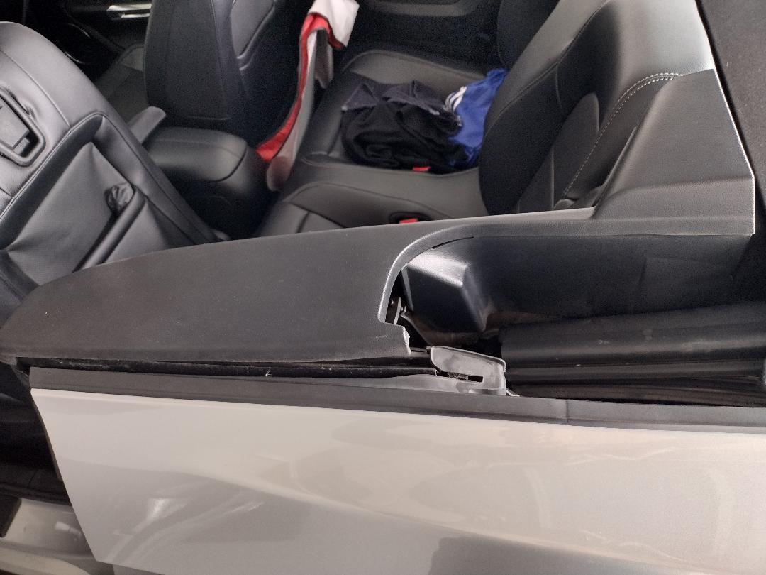

Pictures of Noise control microphones location on Convertible

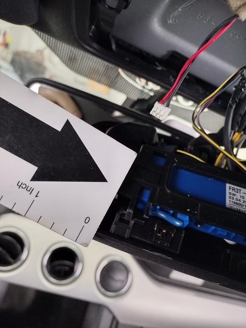

the top center console Microphone, to unplug the wire connection from the Mic. you will have to take the Mic. assy out of its holder and disassemble it to unplug the wire connection.

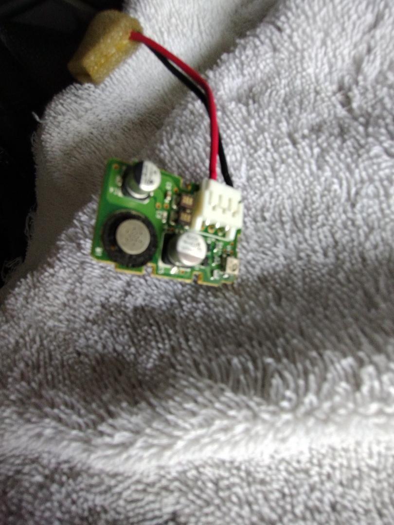

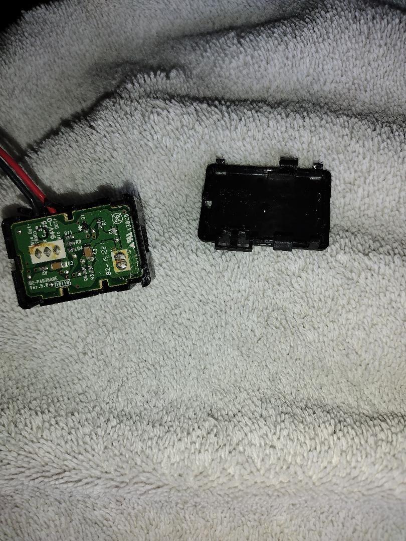

I do not know what car has what. Pictures of Microphone
top center console mic. location wires unplugged
Left side plastic cover
center top is the microphone
Mic. cover off, then take off electrical panel, it just slips out.
disconnect wire plug from Mic. then reassemble mic. with electric plug disconnected.
put the microphone back on the holder and secure the wire plug.
locations.
Last edited by TheFlash; Mar 11, 2023 at 08:19 AM. Reason: There are TWO microphones one on each side, left and right under each cover.
