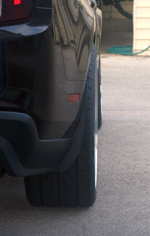

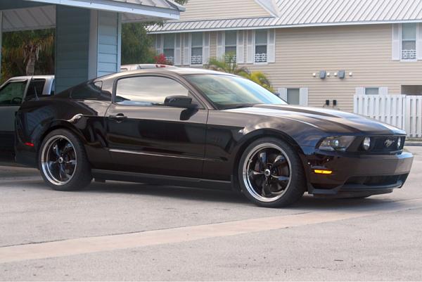

Hey all, I have some potential concerns that I'm trying to address as to the fitment of aftermarket wheels on my car. In boxes for spring, I have some American Racing Torq Thrust M wheels. 20x8.5 +32mm up front and 20x10 34mm out back. I'm concerned about the fitment of that offset on a lowered car. My car is lowered by Ford Racing K Springs, and that was a bit over 1.5" drop all around.
I plan on running a 255/35 up front, and for proper tire height, a 295/30 out back.
Can anyone give insight as to recommended tire sizes and offsets? I now what people put on their Mustangs runs the gamut, but wheel offset plays a big part, as does doing things that provide extra clearance.
The reason for my concern is due to seeing the fitment on someone's car that an a 275/35. A tire that is narrower, but also taller than stock as well.
These as two pics that show his rear wheel fitment. Luckily, he too is running K Springs.

Your rear wheels are going to be 1" further out than stock Brembo wheels. Most people doing wide rear wheels go higher offset in the back to avoid the wheel poking out.

Well I guess Ordie's car looks perfect with the K's and 275/35's... Im just concerned about the 295/30 and how the impact would be. Also being dead of winter I'm anxious as heck to get these wheels on, but it'll be a few months yet.

It sounds like you just want people to reassure you the wheels you got won't stick out... however, the offsets aren't ideal for running wide wheels and tires. There are some wheel offset calculators (search the 1010tires site). Unfortunately, the offset would be perfect if the wheel was 9.5". That extra .5" means it'll stick out .25" more than preferable.
Another way to look at it is the offset are nearly the same as RTR wheels but you're running .5" wider.
My suggestion if you really don't want it to stick out, sell/return them and find a better setup.
