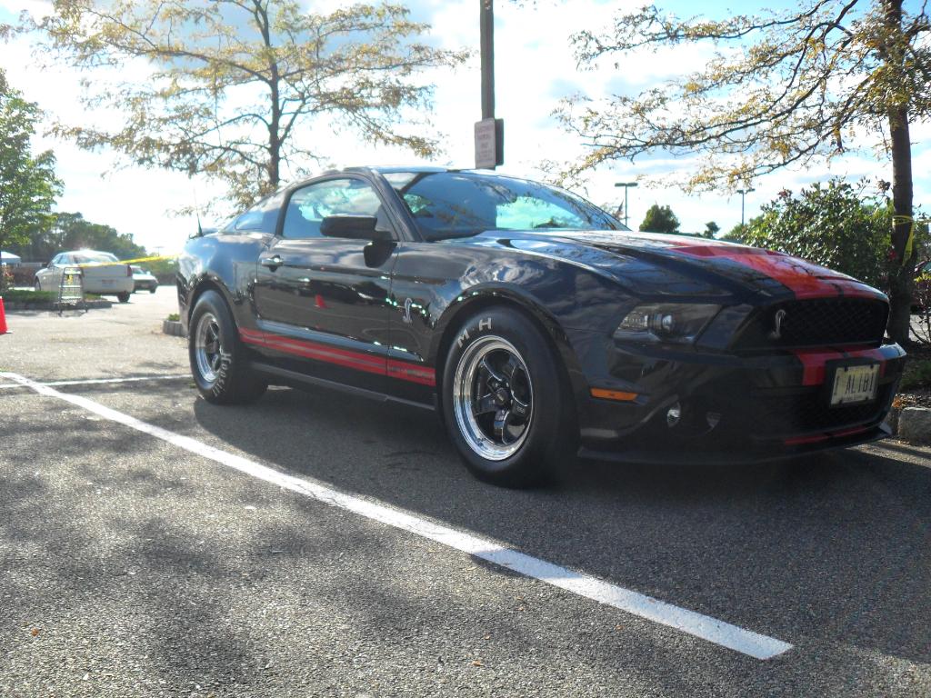

These fronts are 17", with the correct offset & backspacing you can clear the front brakes.

Well the wheel is all of 3" wide. I intend to turn with these.
