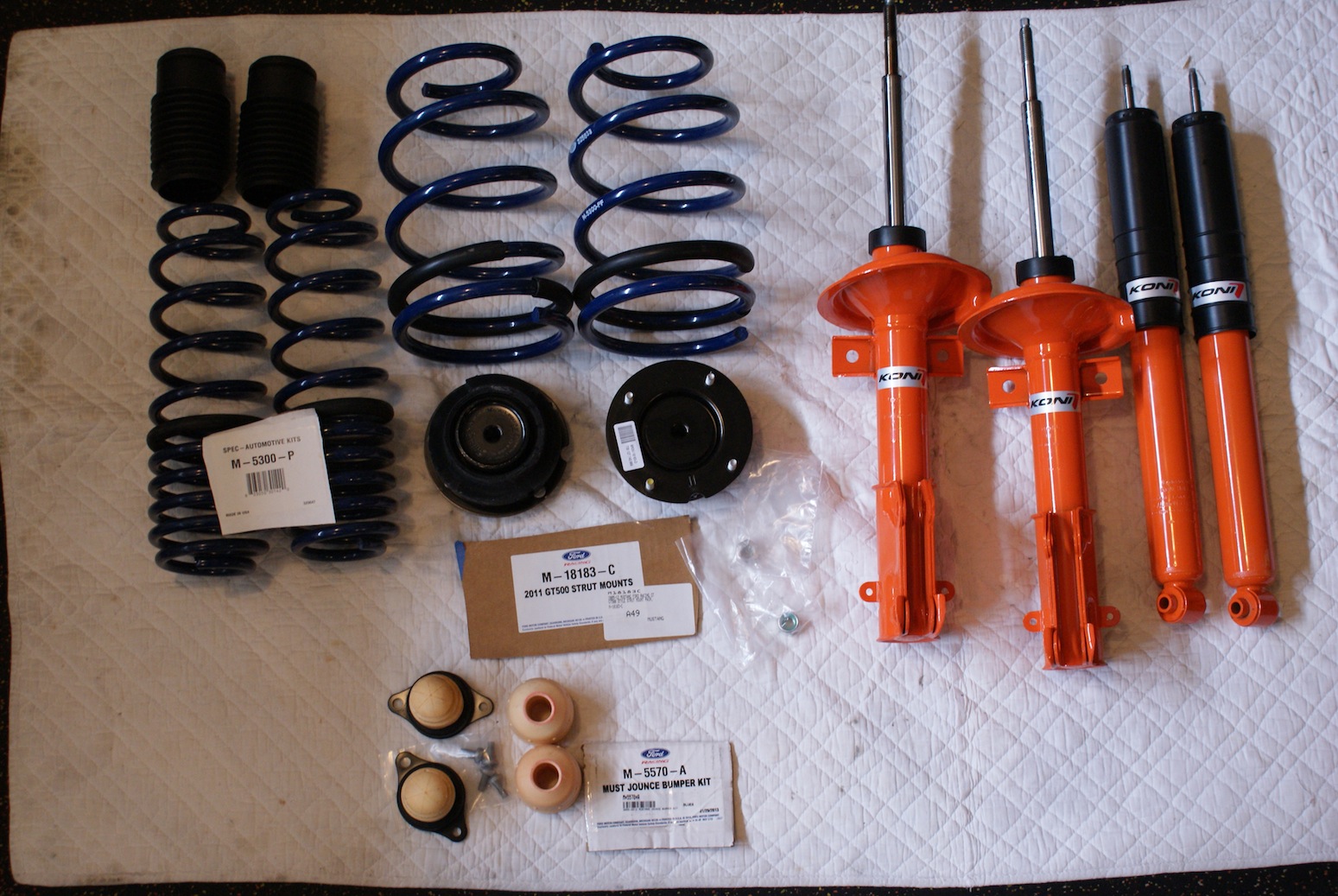

It feels funny clicking "new topic" to share this as there seem to be many threads on this topic presently. FRPP P springs, Koni STR-T, GT500 mounts, FRPP bump stops, Whiteline panhard bar, Whiteline camber bolts.
While I was researching the "how to" part of this there seemed to be some common questions, so I'll try to cover my experience with those.

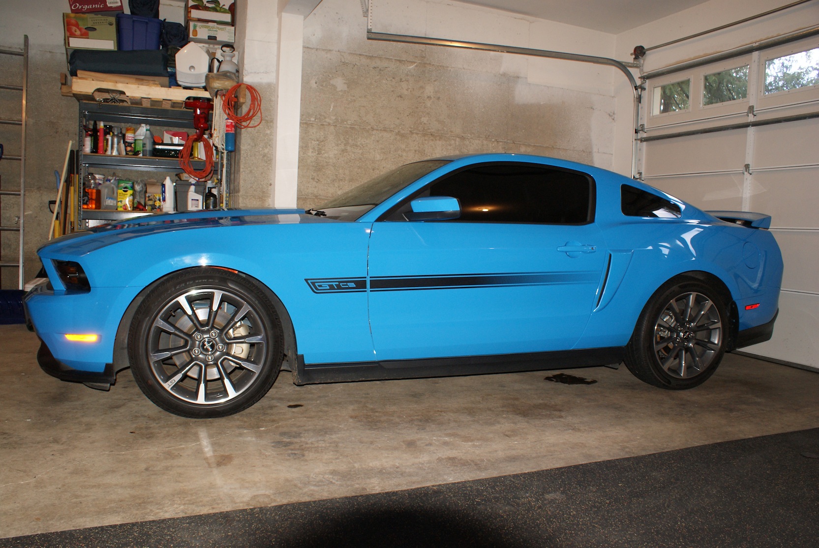

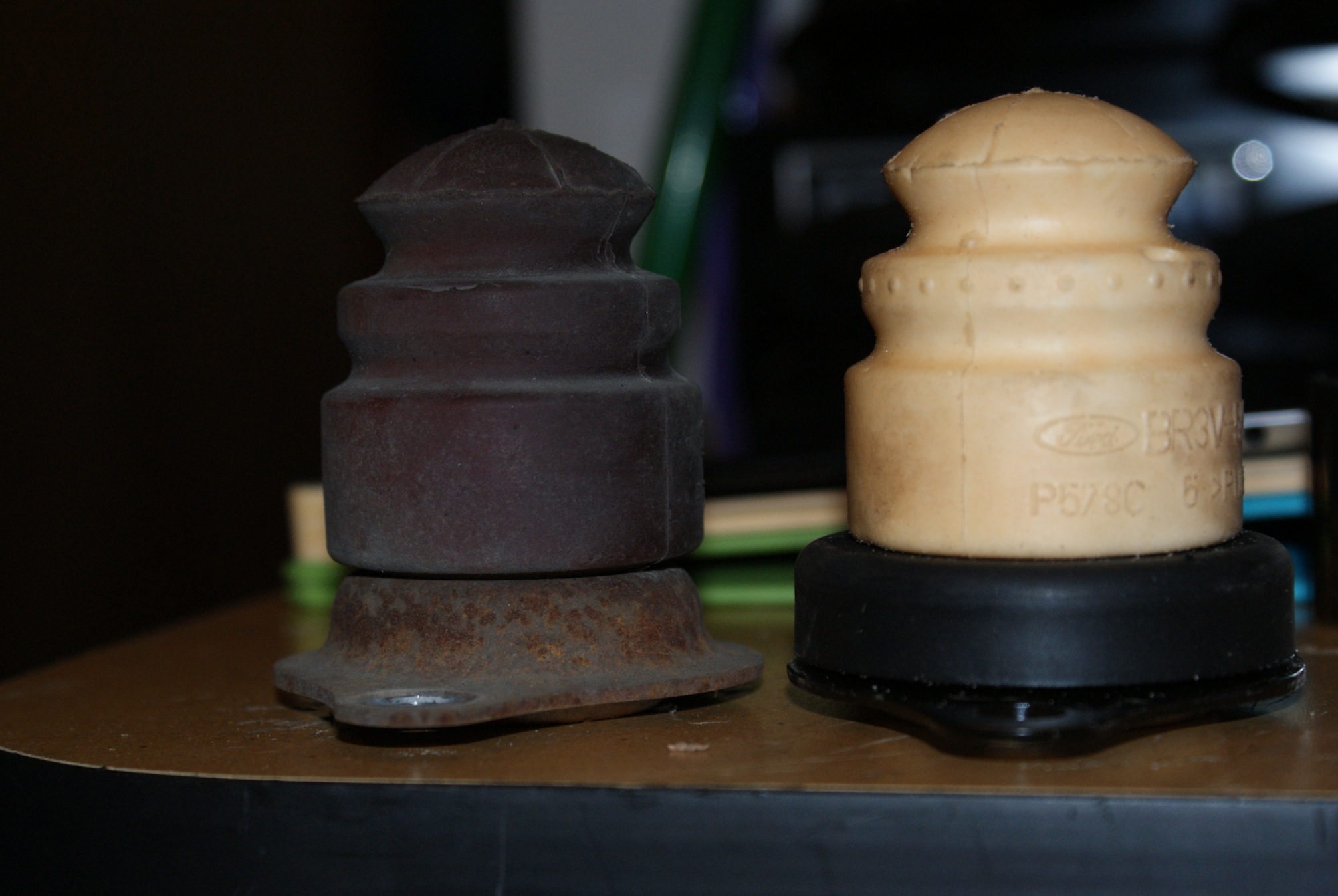

1. What parts do I need? In my 1st photo, I tried to capture the ford part numbers.

3. Do I need bump stops? Again, with p springs probably not, but I chose to get them. Why not as they're $20 through Tousley Ford? They are the same height as stock but softer.

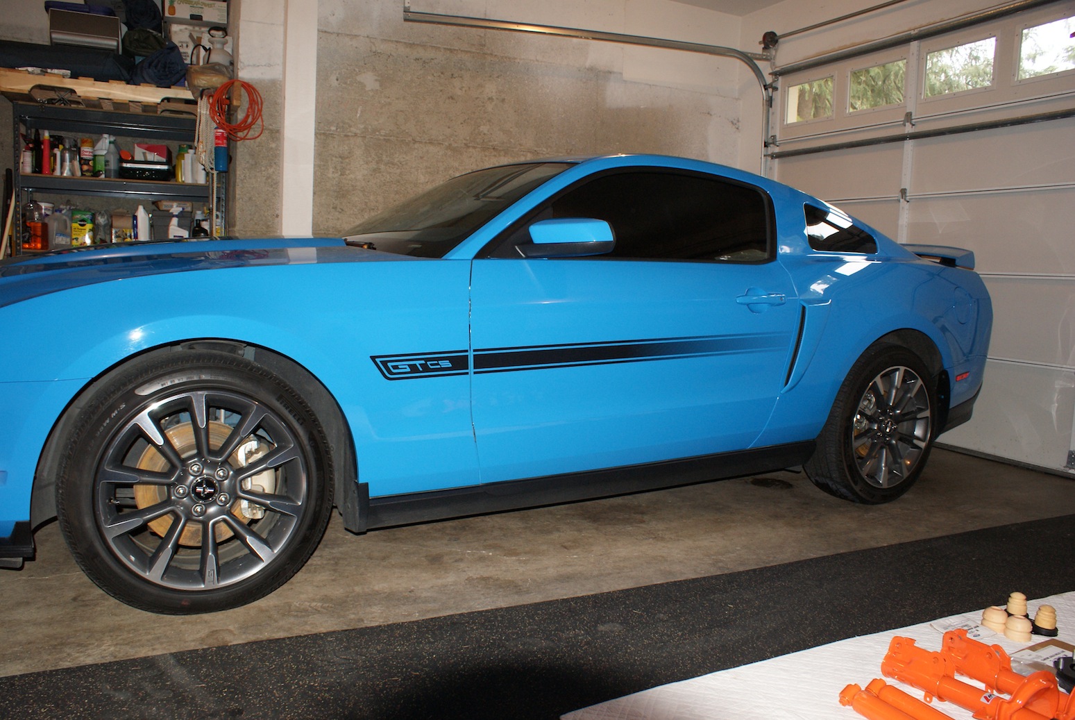

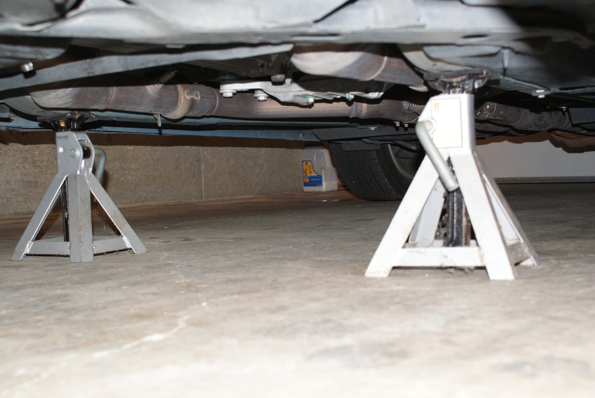

4. Where do I put my jack stands? I have a photo of where I placed mine, but there are many good reference photos.

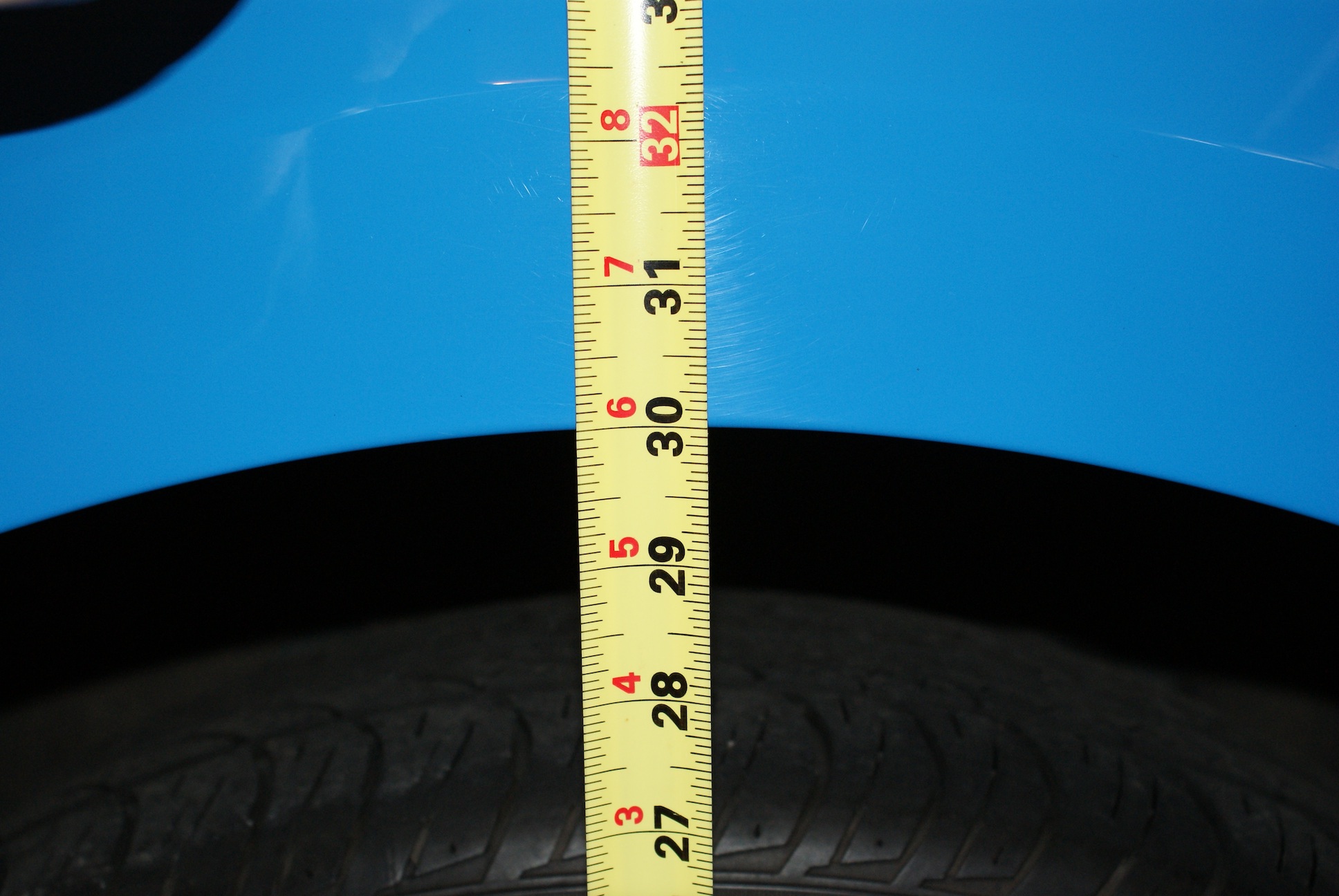

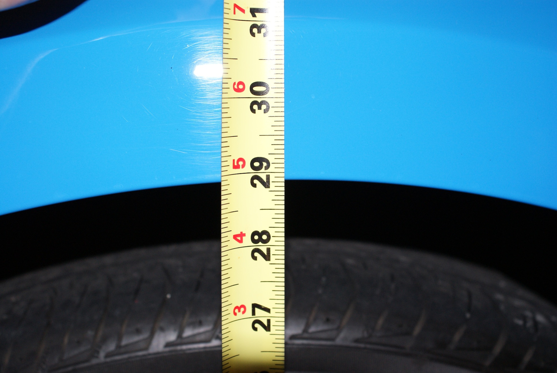

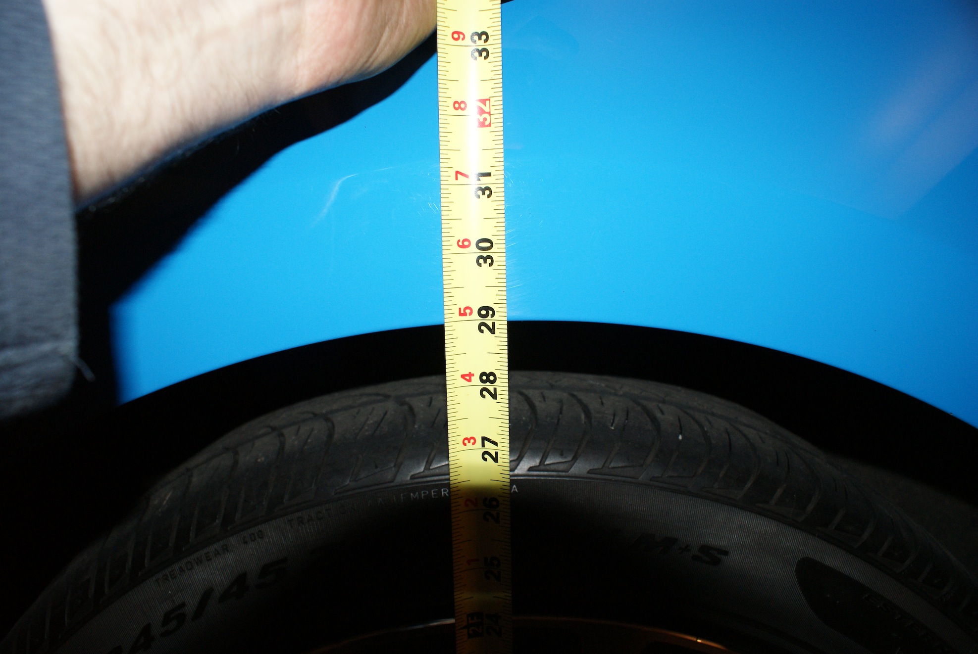

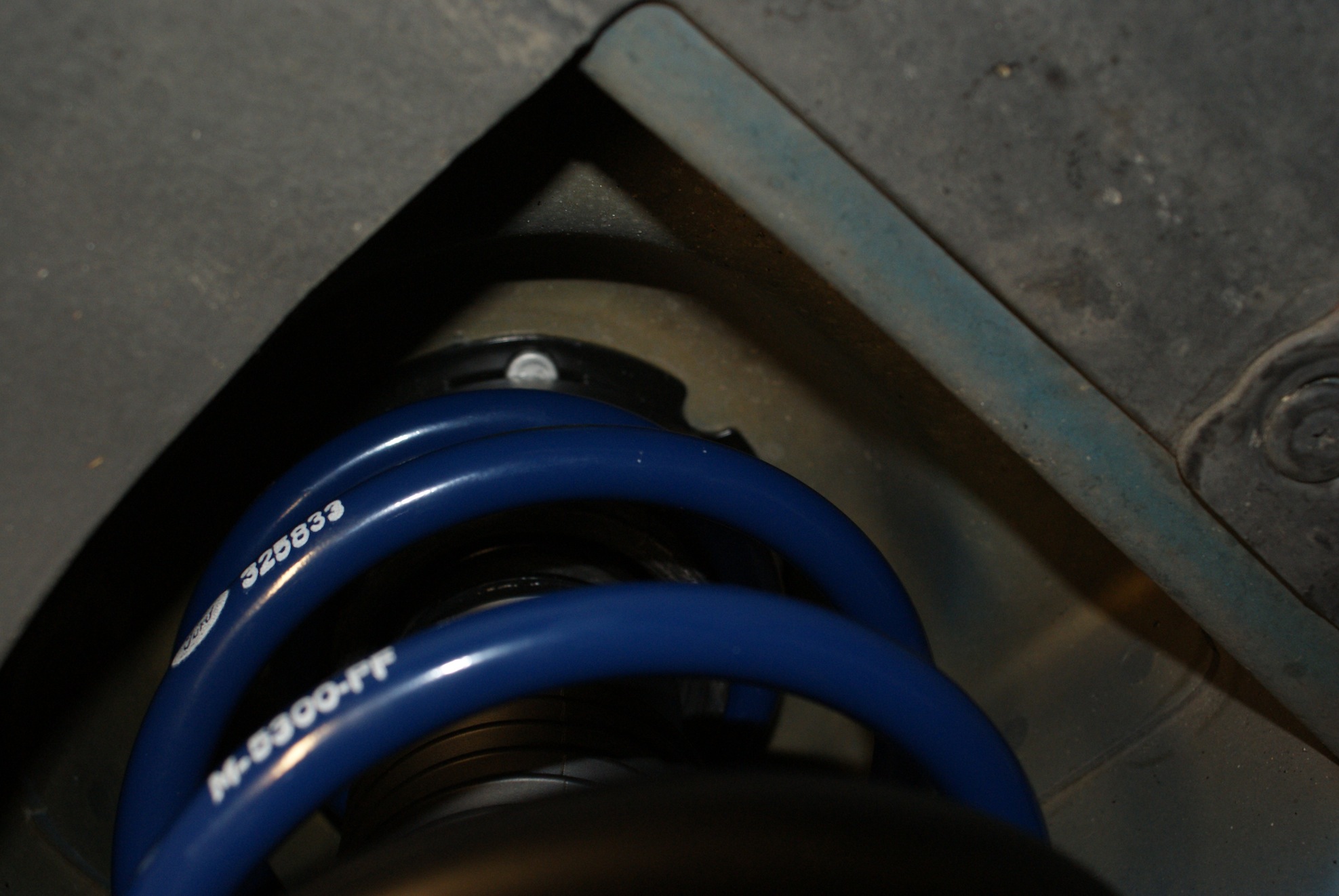

When I first drove the car after changing the suspension, I wondered if I was going to like it... impact harshness goes up a fair amount (maybe 20%), but the wiggle and brake dive of the stock suspension was greatly reduced. (the things that bothered me about the stock set up.. I don't really care about wheel gap, although it does look better) After a few weeks of the suspension settling and my getting used to it, I can say I would recommend this mod. These springs lowered my car exactly 1" in the front and in the back. Here are some photos of the process. Guess I have to change my sig now

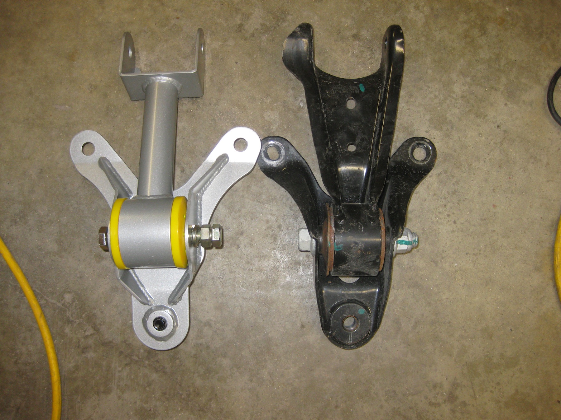

I just completed the same upgrades with identical parts and i would also recommend an adjustable uca to maintain proper pinion angle.

Here are some better before and after pics. So happy to be rid of the brake dive and body movement of the stock suspension. It's occasionally a little harsher than I like, but the trade off is worth it.
