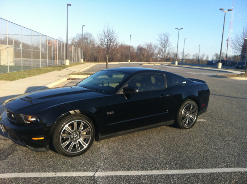

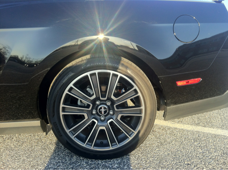

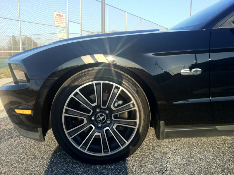

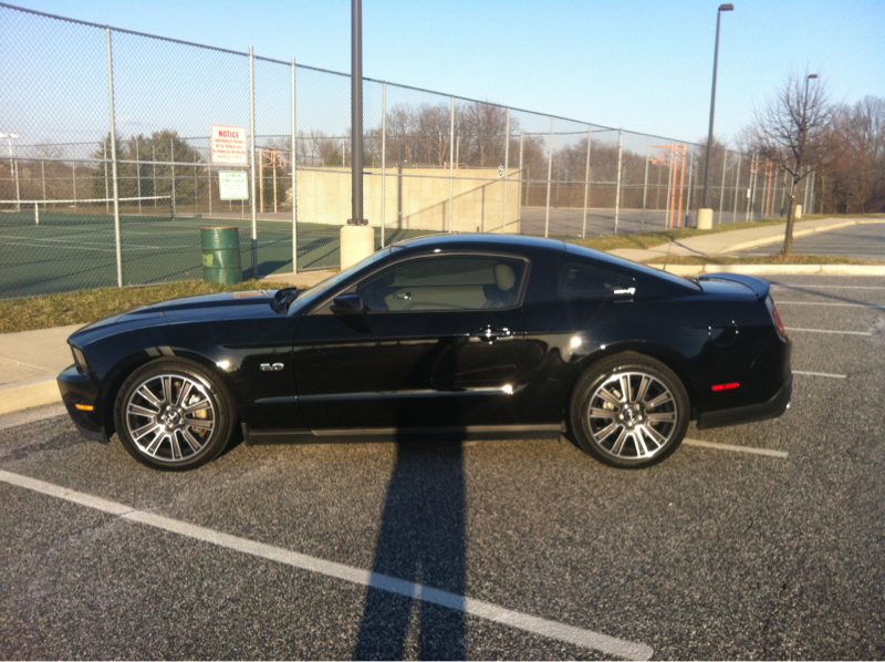

Update, Koni STR's with SVE Springs, GT500 Mounts and dust boots for the front by Gabriel, I also used Ford Racing Bump Stops.
Excellent, my total setback is about $625 my original struts are as is, reduced the install time by a few hours. I assembled the new system before removing the old one. The assembly took about 20 minutes each and then another 45 mins to remove and install the system, so about 2.5 hours total roughly working alone at a leisurely pace. I could have saved about $60 by reusing the dust boots and bump stops, oh well.
I love the handling, accelerating feels strong and car seems to be stickier. I downloaded the BMW M App that has a GPS performance meter that measures 0 to 60 and G forces. It recorded 0.8 G lateral, but that is no measure I was on a small errand run only and max speed was 50 only.
I love this set up.

That looks really good ... makes me look like a total slacker not having my stuff installed yet ... lol

To the OP, it does look good. What drop are the springs supposed to settle to?
