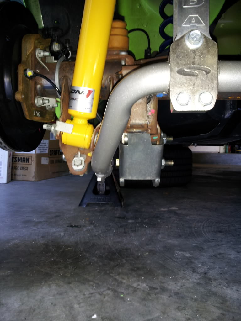

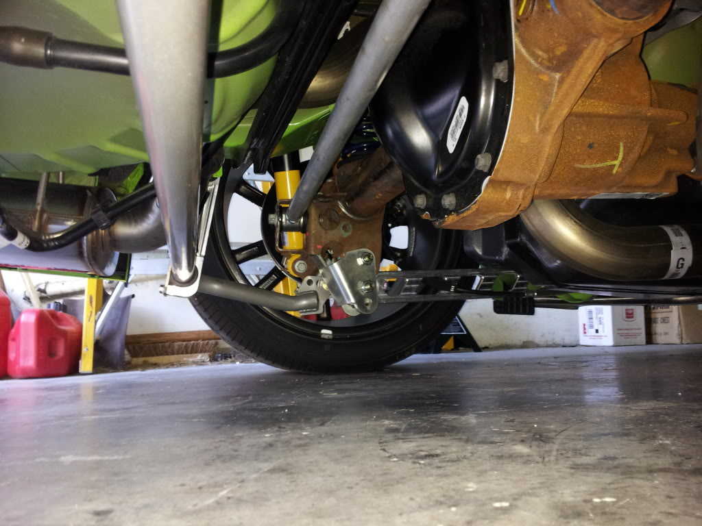

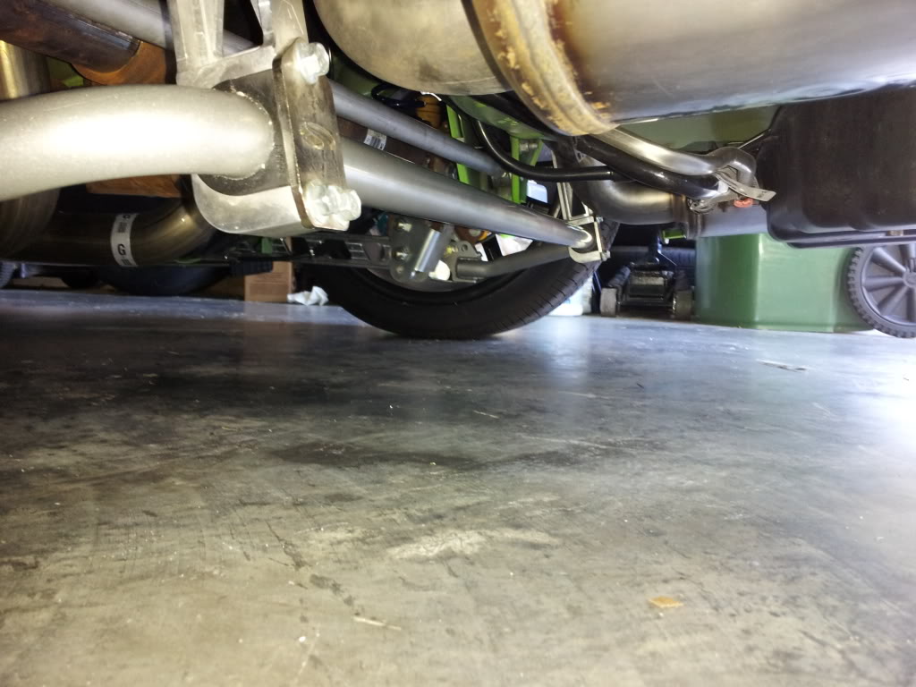

I much prefer the suspension on my 2013 "Koni/Steeda GT" over the original suspension on my old 2012 Boss. Besides being lowered, it feels much more like it's "on rails" so to speak and very little dive when hitting the brakes. I also have a Steeda 1 1/4" tubular adjustable rear swaybar on my GT, which I have adjusted on its lightest adjustment. Below are some photos showing my setup on the rear.
looks good!
