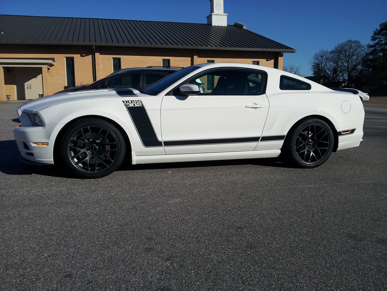

I ran the Koni Yellows with Hotchkis sport springs in our 13 boss. With the springs they completely eliminated the rake that the stock springs had. The spring rate is a tad on the light side being 185 front and 185 rear progressive but I've had great luck with them thus far.
Here's a quick pick with the springs, you'll see how the car sits even which is something I like.
