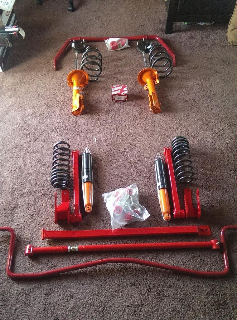

Old Jan 18, 2014 | 07:30 AM
Matt's 95 Stang's Avatar
Joined: June 8, 2013
Posts: 394
From: Downey, Ca
Well my kit is ready and will be going in Sunday. Wish me luck.
