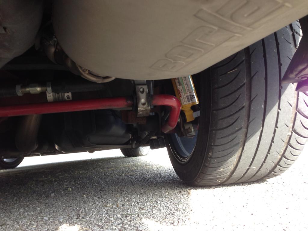

Here is a crappy iPhone picture from the installation. You'll notice that I added Steeda's beefy front sway bar end links, too.

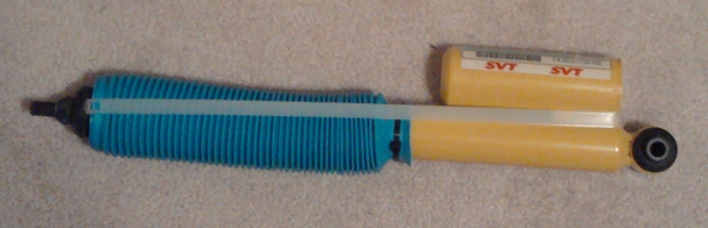

My car's not yet on the road, though, as I ran into two issues. First, the rear Bilstein shocks feature a considerably-different thread than the Koni STR.T's that I had in place previously. Because of this, I had to order 2013-14 GT500 Performance Package-specific "insulators," part no. DR3Z-18197-A. Of course, none of my local Ford dealerships had any in stock, so I turned to Tousley, who always have the lowest prices and excellent customer service. Even with them shipping the parts as quickly as they possibly can, it'll still probably be Thursday before I have the correct insulators in my possession.

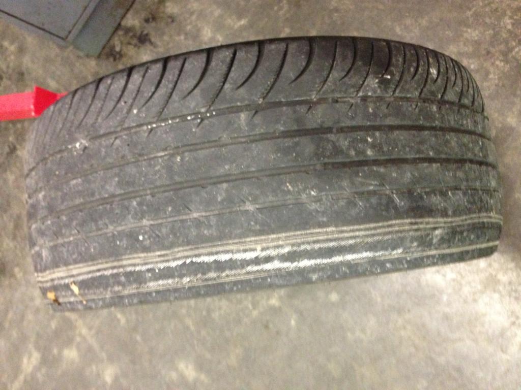

Oh, and my second issue...
...both of my front tires look like this, worn from the inside-out. I wonder if my alignment's out just a tad? I noticed a steering wheel shake over the past week or two (which was definitely more pronounced in Sport mode), but good Lord, I had no idea what was really going on!
I was also going to install my Whiteline upper third link and watts link, but I've since decided to swap the 3.31 gears I've currently got for some 3.73's, so I'll tackle all of the rear axle stuff at once.

Wow, those tyres are a mess, Brandon! Glad you decided to do the upgrade now, rather than later!
Hope everything's all sorted soon for you, matey
Yeah, Paul, there's no telling what would have happened had I kept driving on those tires. Hopefully all will be well and ready to go by the end of next week. I'll keep you posted.

Keep us posted, tough luck about the tires but finding out now saved you from who knows what.

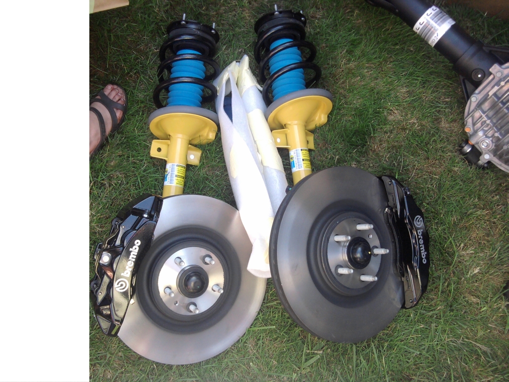

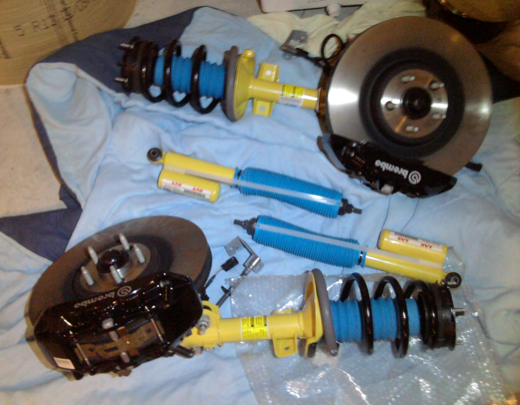

The Bilsteins and 15", six-piston Brembos just installed on my car are off a 2013 GT500. The dampers are electronically-adjustable, but since I don't have a damper module, they'll be permanently stuck in "sport." I just hope they aren't too harsh for daily driving.
I won the front "corner module" assemblies back at Mustang Alley last year. I purchased the rear 2013 GT500 Bilsteins in order to complete the transformation (the rear shocks I got at Mustang Alley were the Boss's five-way adjustable pieces). For the front, all I did was swap the FRPP 1" lowering springs and Steeda HD strut mounts that I already had on my car over to the 2013 Bilstein strut assemblies. I also added Steeda heavy duty front sway bar end links. Out back, I simply swapped the Koni STR.T's for the Bilstein shocks. Once I get the new "insulators" and their correct internal threads, I should be ready to test out the new hardware!

Thanks for the heads-up on the Bilsteins. I have a feeling that, just like you said, they are going to be quite a bit more stiff and jarring than the Koni STR.T's I had on previously. With all four of his FRPP adjustable dampers set to full firm, I drove Overboost's 2011 Mustang 5.0L last year while up in Michigan. As long as my stuck-in-sport-mode-2013-GT500-Bilsteins aren't any firmer than that, I think I'll be okay.
