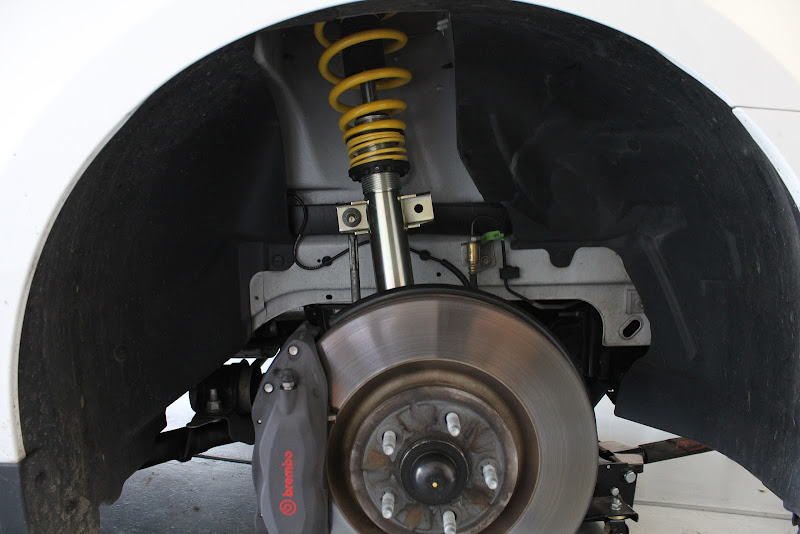

In the front, I drove the car on two 2x4’s (each side) so the floor jack would have clearance when pulling it out. I lifted the car from the k-member with a transverse mounted 2x4 on the floor jack and put jackstands under the pinch seams behind both front wheels. Some are averse to the idea of jacking from the k-member, but I’ve seen no contorting of bending in the metal and this seems to be a quick way to get both sides up off the ground. It’s also good to have both sides of the front end lifted up at the same time so the swaybar is sitting in a neutral position. This will make reattaching the endlinks a piece of cake rather than mission impossible. Remove the wheels and unscrew the brake line (10mm) and pop out the wheel speed sensor clip from the strut (use a set of pliers for this). Using an 18mm deep socket for the nut and a 17mm wrench to hold the bolt in place, undo the swaybar endlink. Undo the two 18mm bolts on the bottom of the strut. Grab a small bucket, cardboard box, or anything you can find to hold the a-arm and hub/brake assembly in place. Don’t let the hub and brake droop and hang by the brake line! The last thing you want is a brake leak to develop. Use a 13mm socket and remove the four nuts holding the strut in place on the strut tower. Carefully remove the strut assembly and get your spring compressors and compress the spring. With the spring compressed, use your awesome offset wrench and a standard wrench or socket to hold the stud in the middle in place. Remove the strut mount and transfer it onto the new strut. The ST coilovers come with awesome little adapters that let you use the 2011 strut mount (which is great, since you don’t have to spend more money on buying 05-10 strut mounts). Set the coilovers to the same height on both sides so you have an even baseline. Slide your new strut back in place and mount it to the strut tower (mount the top of the coilover first). Take the hub and bolt everything back together on the bottom end of the strut. Pop the wheel-speed sensor back in, screw the brake line mount on and throw your wheel back on.

Front strut assembly
spacers to use the coilovers with the 2011 strut mount
how the spacers are installed on the coilover
front strut installed
awesome slotted top bolt (allowed as much as 2.7º of camber!)
