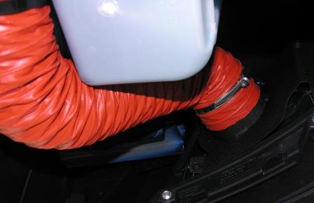

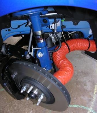

Here's a pic of the 15" kit installed upfront with the Ford Racing adjustable struts and brake cooling kit. The cooling kit is not a straight forward install. I spent a good amount of time Dremeling my inner fender splash panels...AND, the tubing FR supplies is not long enough to snake around the windshield washer reservoir. I guess they assume you have a track-only project car.
I will say one thing, the Brembo/Track Pack wheels from the GT fit, but it is a very close fit. I think there's not much more than 1 mm space. Not happy about, but it could be fine. I will consider some slim wheel spacers possibly.

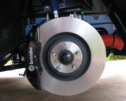

I don't have pics, but I can tell you the rears are fine and the fronts are right on the border. Very little clearance between spokes and calipers. In fact I swear there is some paint that has been rubbed off of one of the corners of one of my calipers. But then I do drive agreesively. I have thought about getting a 1/16th in wheel spacer if I see any real contact. No pics though, but they do fill the the wheels nicely and definetly stop better, but then you probably won't know unless you drive and brake hard. Makes late braking a breeze!

Wow looks great, def a tight fit. Those rears are 13.8???
Old Mar 31, 2014 | 06:02 AM
Cobrakit's Avatar
Joined: March 6, 2013
Posts: 70
Rears are 13.8, so just think how whimpy the stock 11.8 ones look. And if you go to the 15 up front, in my opinion you need the 13.8 rears to balance out the braking effect. I could tell the difference with just the front. Much better brake pedal feel with the rears as well. Only about .02 clearance on the front calipers. Hard to see in the picture.
