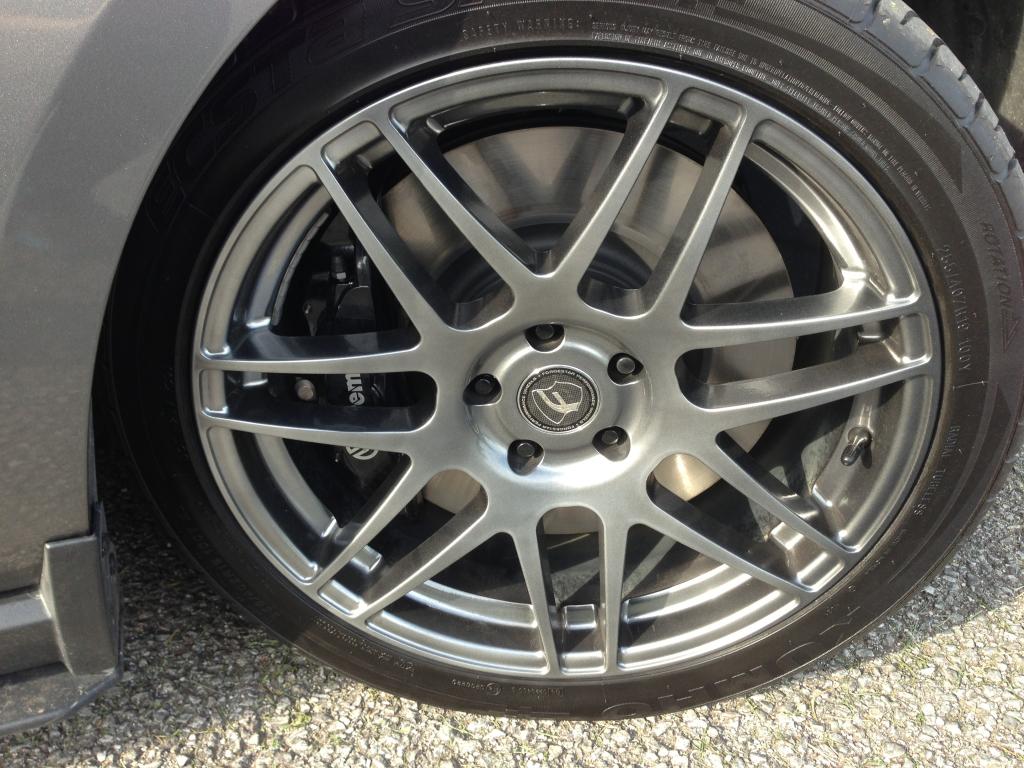

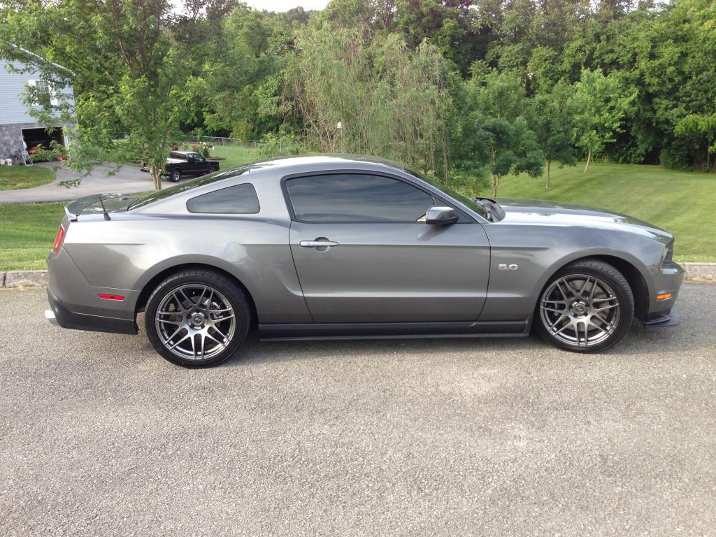

Random. I would just like the rear upgrade separately since I like the fronts already. I might change the color for the fronts though. They are too subdued for my taste. Kind of like the size of the rears. What were they thinking exactly? I think that for the TP cars and above they shouldn't have skimped on the rears.
It's because the front brakes handle the vast majority of the vehicle's braking. That's why, in comparison to the front brakes, they're undersized. The only reason SVT went with larger Ø rear rotors on the 2013-14 GT500 is because of aesthetics; the 2010-12's rear rotors (which were the same size as the GT's) were dwarfed by the 15" front rotors.
I think the 15", six-piston Brembo brakes look fine with otherwise-stock Ø rear rotors, but I may be a bit biased.
Are your wheels 19s or 20s ? They look very nice!
