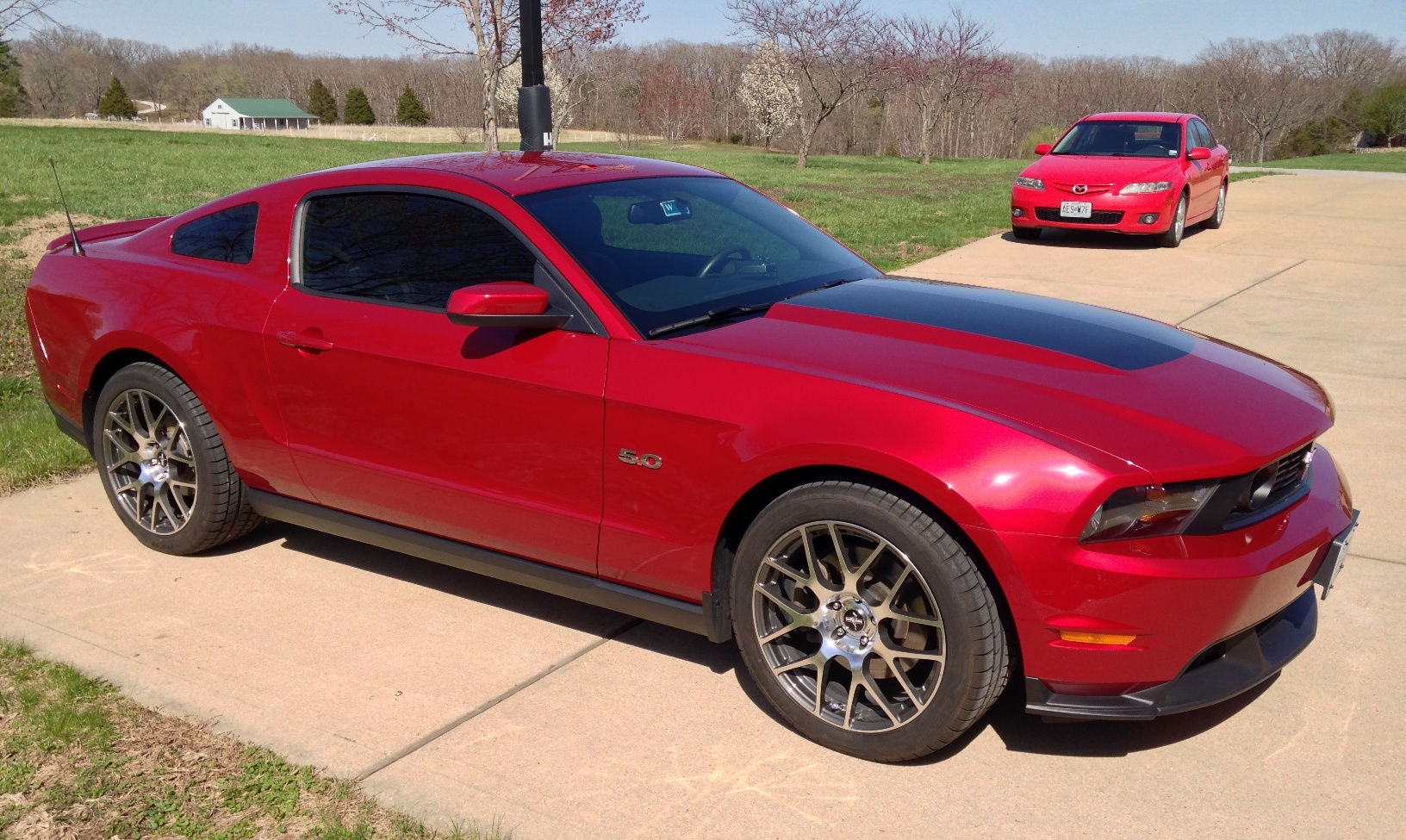

Here you go ... my ‘14 GT with the Roush 1/2” drop kit, tires are 235/50/18 Cooper Zeon RS3-A.
