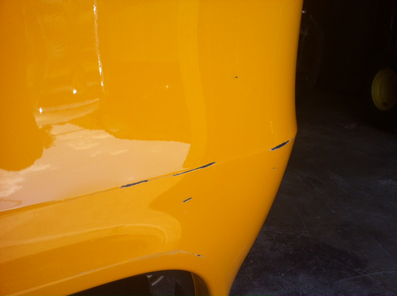

Its scratched rather than dented. The scratches go through the paint to the fiberglass. I don't think I need a new bumper. I will go an take a pic on a while and post it so you can see.

1st off, it would be a collision claim, not comprehensive.
2nd - a bodyshop is going to want to remove and disassemble the bumper for paint, plus they'll charge actual repair time on the damage, then of course shoot the color and clear, then reassemble.
3rd - you'll want to find out if SBY is a 2 or 3 stage paint. If it's 3 stage, it's going to cost a little more in the paint shop.

Ok just sharing, went to a Mustang Specialist today. Looks like it would cost $500 to take off the bumper and fix and spay. The big problem is if they can get the decal on the bumpers on their own. The other option is to work just on the area involved. They can mask and spray, they said it would be less expensive but there would be a slight overlay in clear coat that would not be seen but it could be felt if you ran your fingers over the old and new clear coat. Sooo I am thinking I don't let people run their fingers over my bumper, so I should go that way for now. If I get a ding in the future from someone bumping me then I can get the thing taken off and sprayed another time.

My touch up paint and clear coat turned up today. $27 for the two. It says PEN-BC 2013 SBY and PEN-CC High gloss clearcoat, so I will see when I get it on. Came from Automotivetouchup
