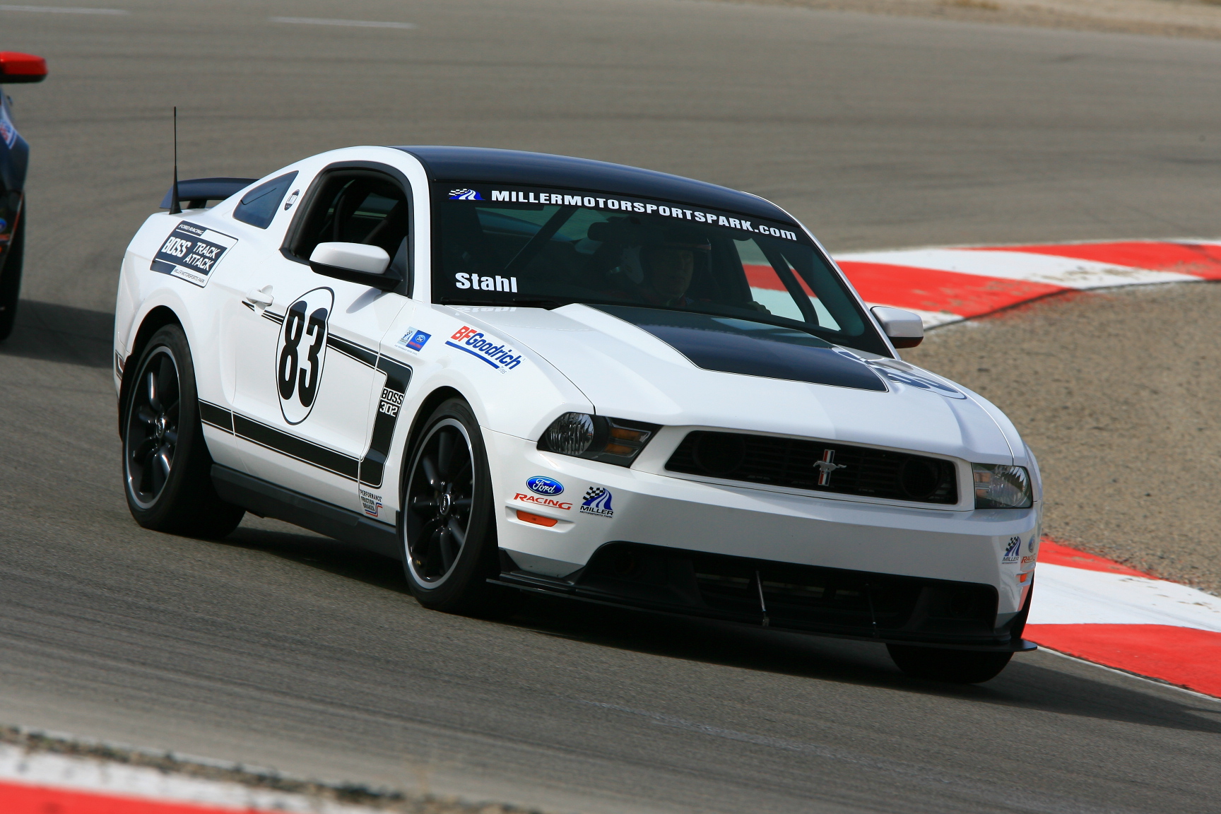

I know I am going to love the track experience... When I was at track attack I beat the crap out of their cars & turned some great laps. (Did break their shifter.. which made me upgrade to a Barton shifter on mine) But I have a hard time REALLY beating my own cars so with that being said I believe this track day will be a one off for my car. (covered in tons of tape) Do you still think I should consider cooler, pads, & fluid?
Painters tape works well. See my avatar.
I've never tracked a car on stock pads or fluid. But I'm pretty sure some people have.
If its a one-time thing, and you hold back from your max capability, you'll probably be ok. Check the pads and bleed the brakes before and after the event--the stock pads may be done after one event.
