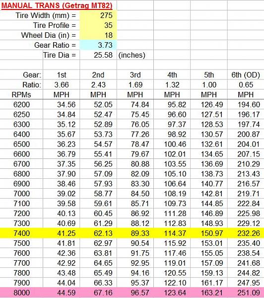

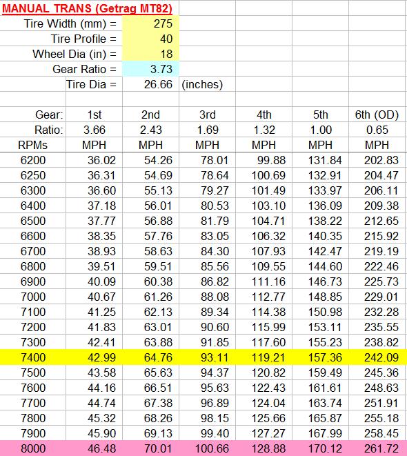

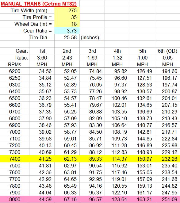

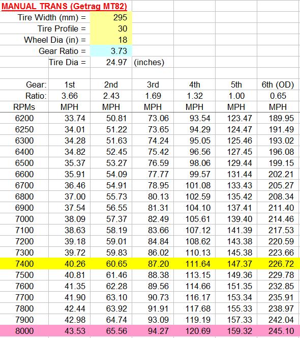

Cloud9 I think your calculations are a little off. Also the Red Key should remove the top speed limiter. Furthermore, while the BOSS might not make any additional power above 7400, you should be able to run it up to 8000? (estimate) on the Red Key tune. I think I remember hearing the 302Rs redline at 8400!
Even if that's not an option, 157 with a 275/40 is pretty fast. You should still go to 6th gear if you need more speed...it will not pull much however as you already know.
Here is the BOSS/GT Gearing with a few different common race tire sizes (obviously the 6th gear figures will be unachievable):
Attached Thumbnails Transmission Gearing on the Boss - Please help splain this to me-2754018.jpg   Transmission Gearing on the Boss - Please help splain this to me-2753518.jpg   Transmission Gearing on the Boss - Please help splain this to me-2953018.jpg
