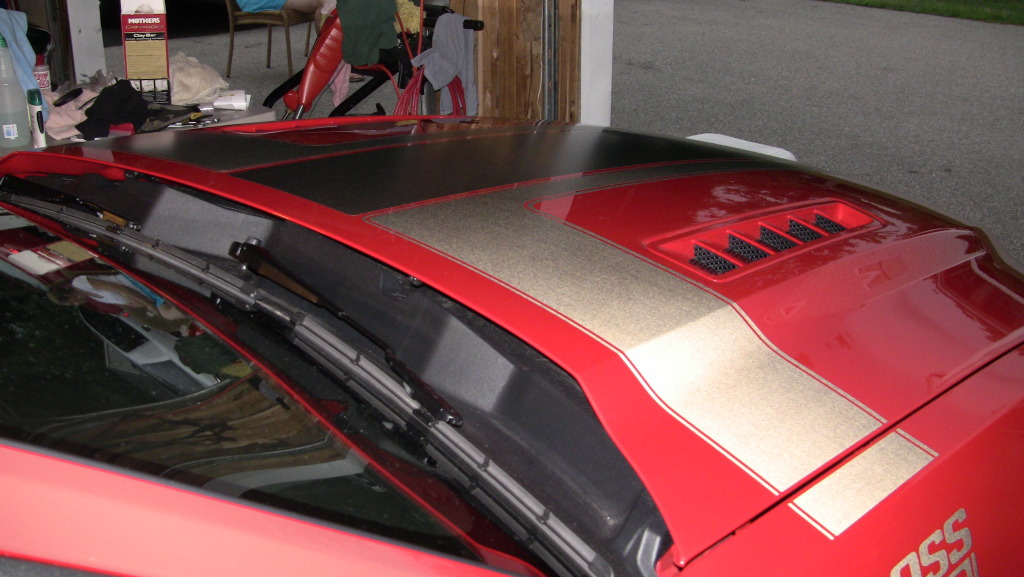

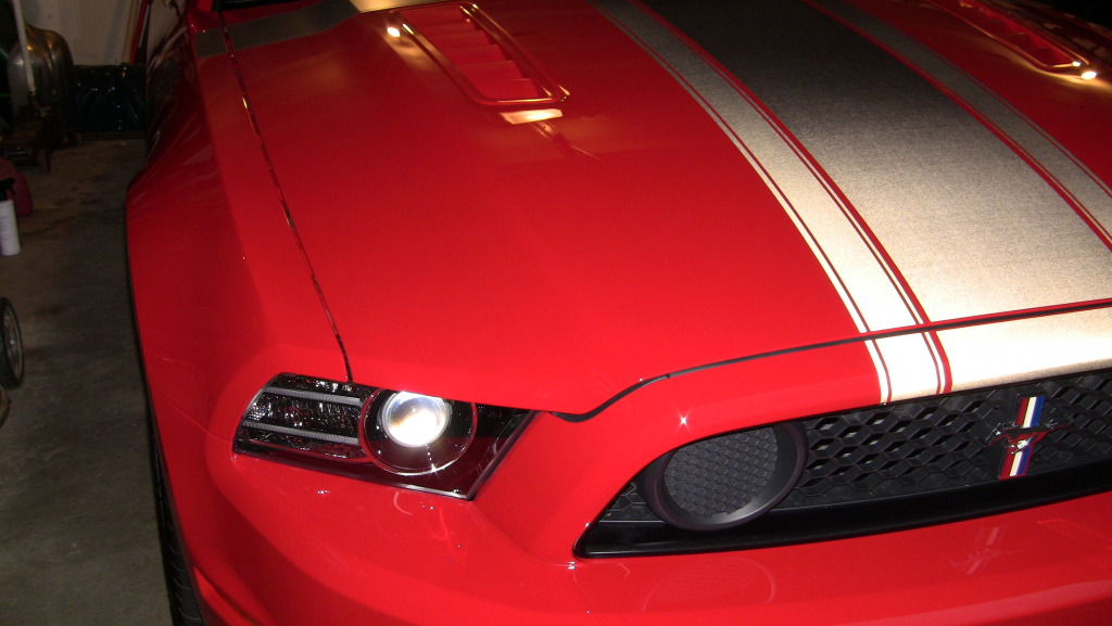

http://www.zainostore.com/Merchant2/...oduct_Code=Z-6
This stuff works great, after a wash and dry, spraying this stuff on shines them up and provides UV protection.
