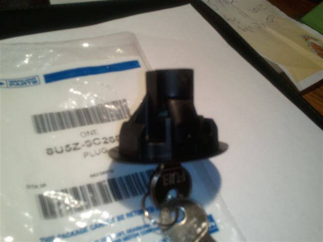

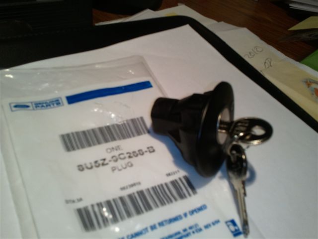

Purchased the locking cap and it arrived yesterday. It's really small compared to "traditional" locking caps. And it does not have a rubber gasket or seal. It's what the name implies......a locking gas cap. You appear to need to have the key inserted in the lock to insert the cap into the fill pipe opening, and then turn the key in the cylinder to lock the cap and remove the key. Here's a couple of photos of the cap

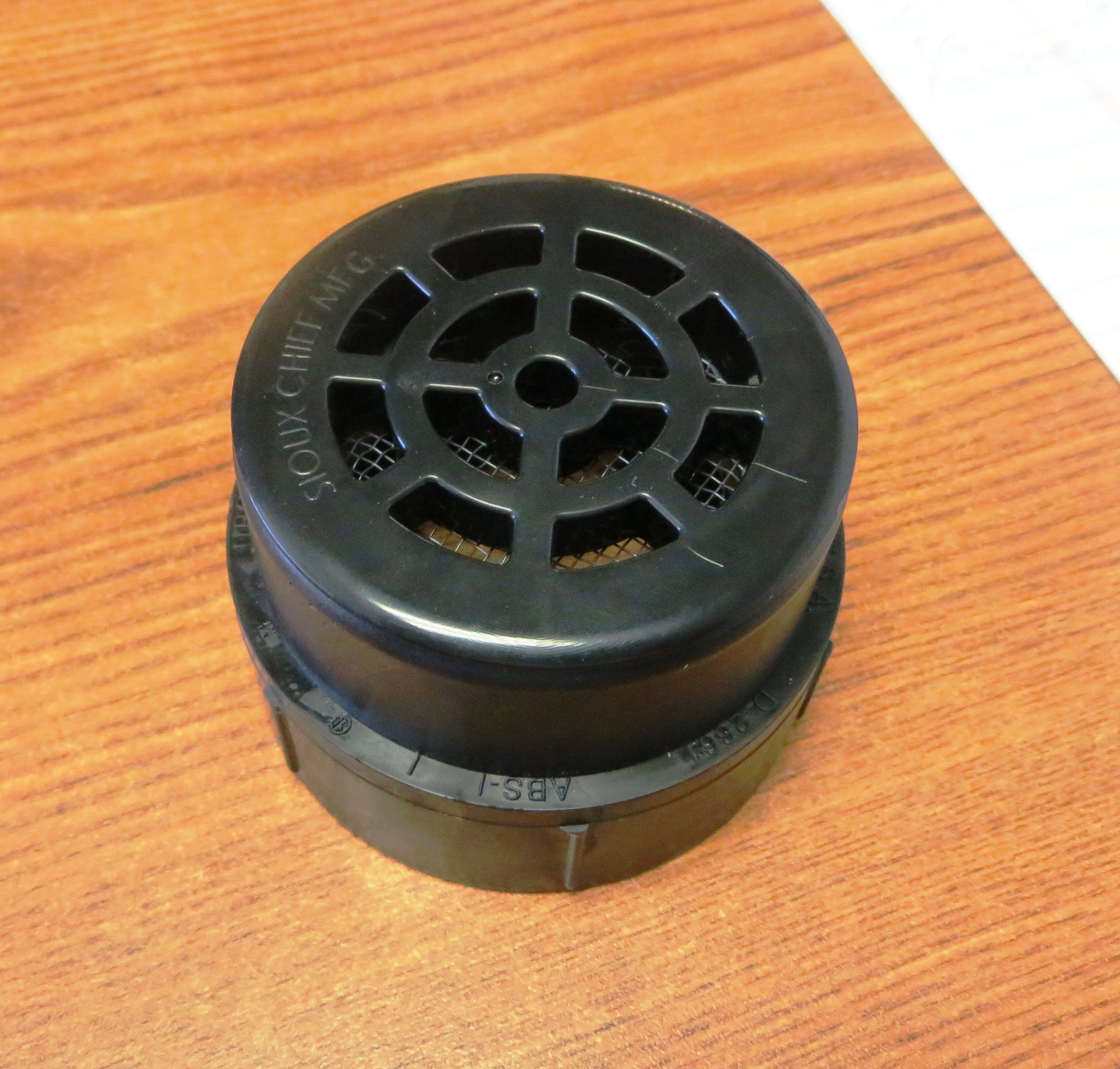

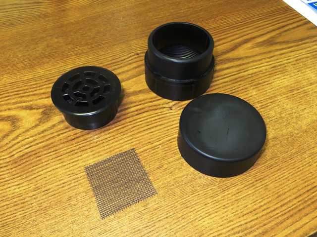

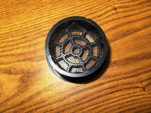

Brake Cooling Plug
A new spin on the front opening for the Boss brake cooling duct. I added the 2" flush fit pipe drain and a 2" x 2" screen behind it to keep the little critters out. I'll super glue the screen in and use PVC glue to mount the flush drain to the part that fits into the lower front fascia. Haven't tried it yet but in non-rain, off-track hard motoring, you can still get some air to those breaks.
PS: If you choose to stop any air, the original cap will still snugly fit over this contraption.
