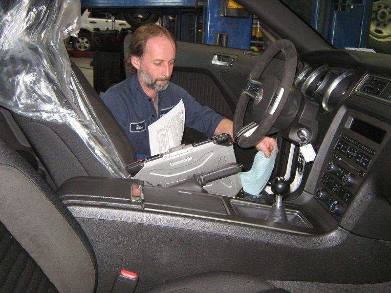

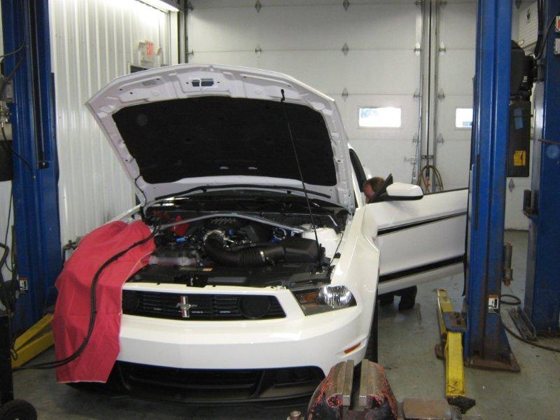

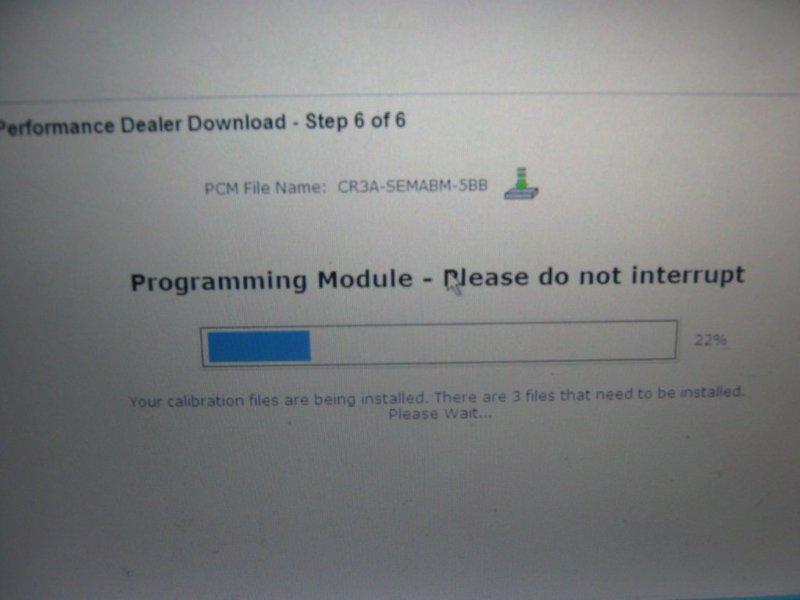

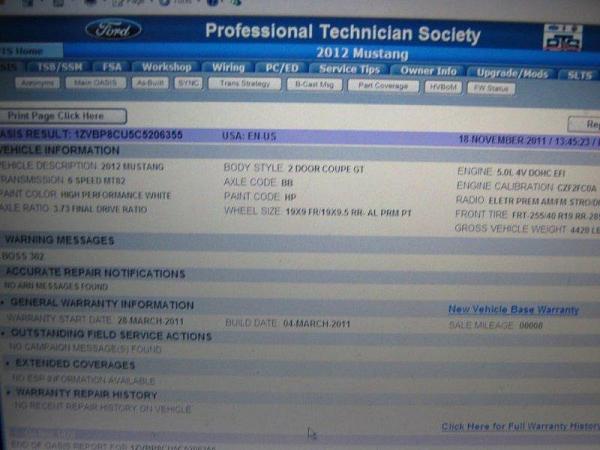

The install went very smooth in and out within an hour.
I ordered my car in 9/2010 and the dealer had know idea what they had at the time. So my deal was at invoice and a WE-OWE from the dealer for the Trackey program when it became available. My salesman called last week with my appointment for the program but was quick to tell me it cost $302 + labor. I reminded him about the WE OWE and they were actually going to honor it. I felt bad, so I told him I would pay for the program if they covered the labor which they did. Great group of guys.
I must say though it may not be the best $302. I have ever spent. Maybe I just need to drive it a little more. I can`t tell a hole lot of difference.

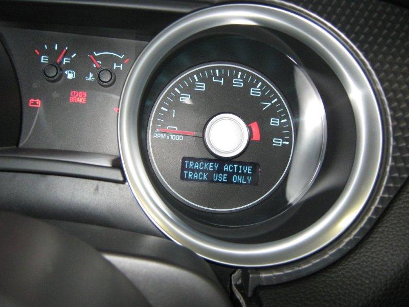

Has anyone seen the message display TRACK IDLE ENABLE or TRACK ENGINE ENABLE???
I have not seen either display but after our test drive the mechanic who loaded the program said he could tell a difference in the idle.... It felt the same to me.
I received my 91+ sticker with the program and the lame fender sticker within a few days of the install. No instructions, no thank you,... nothing... which I thought was pretty weak for $302.
I think Ford could have done a little better job on the release with some nice packaging, DVD instruction and little more bang for the buck.
Still love everything about the car but bottom line if you want an on the edge performance tune my opinion Trackey is not it.
Attached Thumbnails BOSS 228 GETS TRACKEY 11/18/11-ls-wheels-4.jpg   BOSS 228 GETS TRACKEY 11/18/11-boss-trackkey-002.jpg   BOSS 228 GETS TRACKEY 11/18/11-boss-trackkey-003.jpg   BOSS 228 GETS TRACKEY 11/18/11-boss-trackkey-005.jpg   BOSS 228 GETS TRACKEY 11/18/11-boss-trackkey-006.jpg

It is not installed if it doesn't show on the display
Old Nov 24, 2011 | 11:20 AM
5 DOT 0's Avatar
Joined: December 18, 2010
Posts: 3,708
From: NorCal
Yep and it shows in the photo posted.
The TK Engine or Idle Enabled comes on after the car has reached operating temperature and 130 seconds have elapsed. You are using the red key right? Ford never promised TK was going to transform your Boss into something else. If all you're buying it for is the idle then yeah I'd pass too. I'm happy with mine and have been running the red key most of the time since my install.

I get what is displayed in the picture.
I have not seen Trackey Engine or Idle Enabled.
Does the engine need to "remain at idle" for 130 seconds without be disturbed after reaching temperature?
I have only run it about 30 minutes since the install and I am pretty certain I was unable to keep my foot off the throttle for that long.
No. Just drive it around. Once the engine has hit 170 and the 130secs have elapsed since hitting 170, you should get the engine or idle enabled display when you are NOT at idle. If you were at idle for the 130 secs after 170 temp is reached, a blip of the throttle will initiate the engine or idle enabled display. If you don't change your display, the two messages "Trackey enabled" and "engine/idle enabled" will alternately display.
You will not get Engine/idle enabled if there are any misfires, codes, etc. One person posted that the skip shift disabler caused his car to not go into engine/idle enabled mode.
